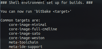

Running the . export command generated an output where following was mentioned.
Screenshot 2023-09-20 103554
So, I thought it would be safe to go with what bitbake generated. I misunderstood common targets to be recommended targets.
