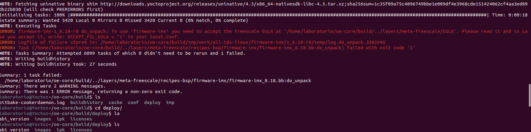

So if it is, I have remove it and the bitbake started to compile. But at the end the uboot is generated, but not the full image. The error is shown in the attached image.
Any idea is appreciated.
Hi @henrique.tx ,
Thank you for your advices. I have updated the manifest and did a repo sync to get the last version of the recipes from Toradex. I also included ACCEPT_FSL_EULA=1 in my local.conf.
Everything worked fine and I did get the image build.
Thank you very much for the support and your good sight!!!
