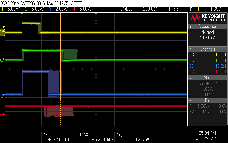

Here are some first results:
CH1: falling edge after waiting a predefined time
CH2+3: Falling edge after SPI transfer is finished
CH4: _CS-line
Source-code and further information: [iMX8] SPI Real Time Performance - Technical Support - Toradex Community

@jaski.tx ,
Thank you very much for the links, I’m aware of the difference between latency and throughput. What bothers us at the moment is not that the SPI transfer takes too long (=throughput), but that it’s jitter is >100% of the maxmium SPI transfer time.
Our first priority is to reduce the jitter of the SPI transfer duration (falling edges on CH2 and CH3 above). This jitter way bigger than the duration of the two SPI transfers.
  • SPI transfer #1: time between first _CS LOW (=CH4) and the falling edge on CH3
  • SPI transfer #2: time between second _CS LOW (=CH4) and the falling edge on CH2
