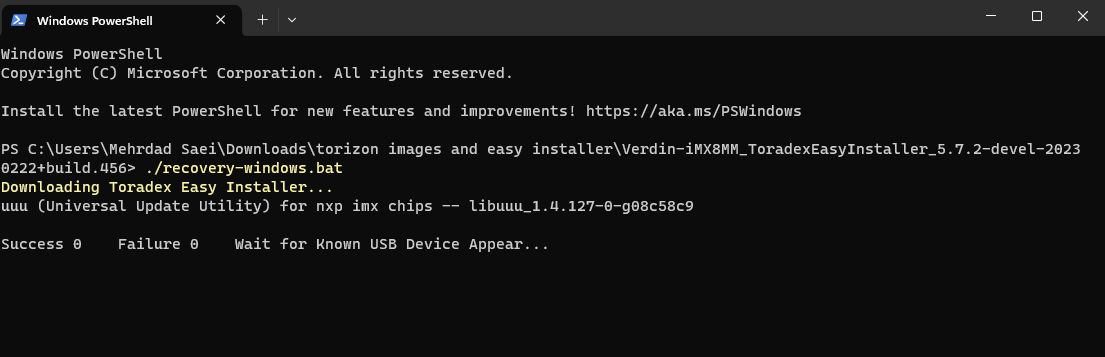

When I insert the SoM and press the turn-on button, nothing happens, just the led is on, and I hear noises similar to bee insects. I also tried using the recovery button and turned it on, but same result.
The latest I modified the DT was when I installed TorizonCore5 with this image :
torizon-core-docker-verdin-imx8mm-Tezi_5.7.0+build.17.tar
easy installer that I use for recovery is :
Verdin-iMX8MM_ToradexEasyInstaller_5.7.2-devel-20230222+build.456
And I cannot not access to the SoM details unfortunately :frowning:

So you can’t access the serial port console from the installed image?
You also can’t load Toradex Easy Installer to the module, that’s right?
Please share the outputs of the Toradex recovery script of an attempt of loading Toradex Easy Installer.
Hi @henrique.tx ,
I can not access to the serial port and load the easy installer
The red LED for reset is on. would be a good idea if you could test it.
