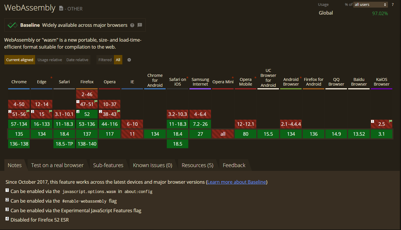

Assuming I can trust CanIUse, it looks like browser compatibility shouldn’t be much of a concern for me.
Hey again David,
Then it makes total sense to go for it, it seems like a good architecture. For the HTTP server, I suggest you to evaluate between the most common ones like nginx, httpd, lighthttpd, caddy etc. Most of them should have officlal Docker images, too. Load-testing each server is also a good idea depending on how many connections you’ll make to the device.
