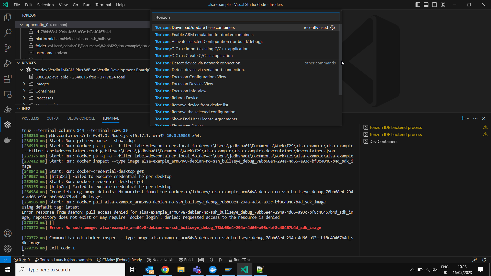

Hello @jeremias.tx ,
I think this error is probably because the alsa-example files are not within a container. See log attached. This log is from the terminal after using the following option:
open in remote window (bottom left blue icon in vscode) → reopen in container
Strangely, I do not see any option from view-> command palette which says Torizon: rebuild and reopen in container. I think this option is present in the extension, however in this case, have no idea why it is not shown.
alsa log.txt (7.6 KB)

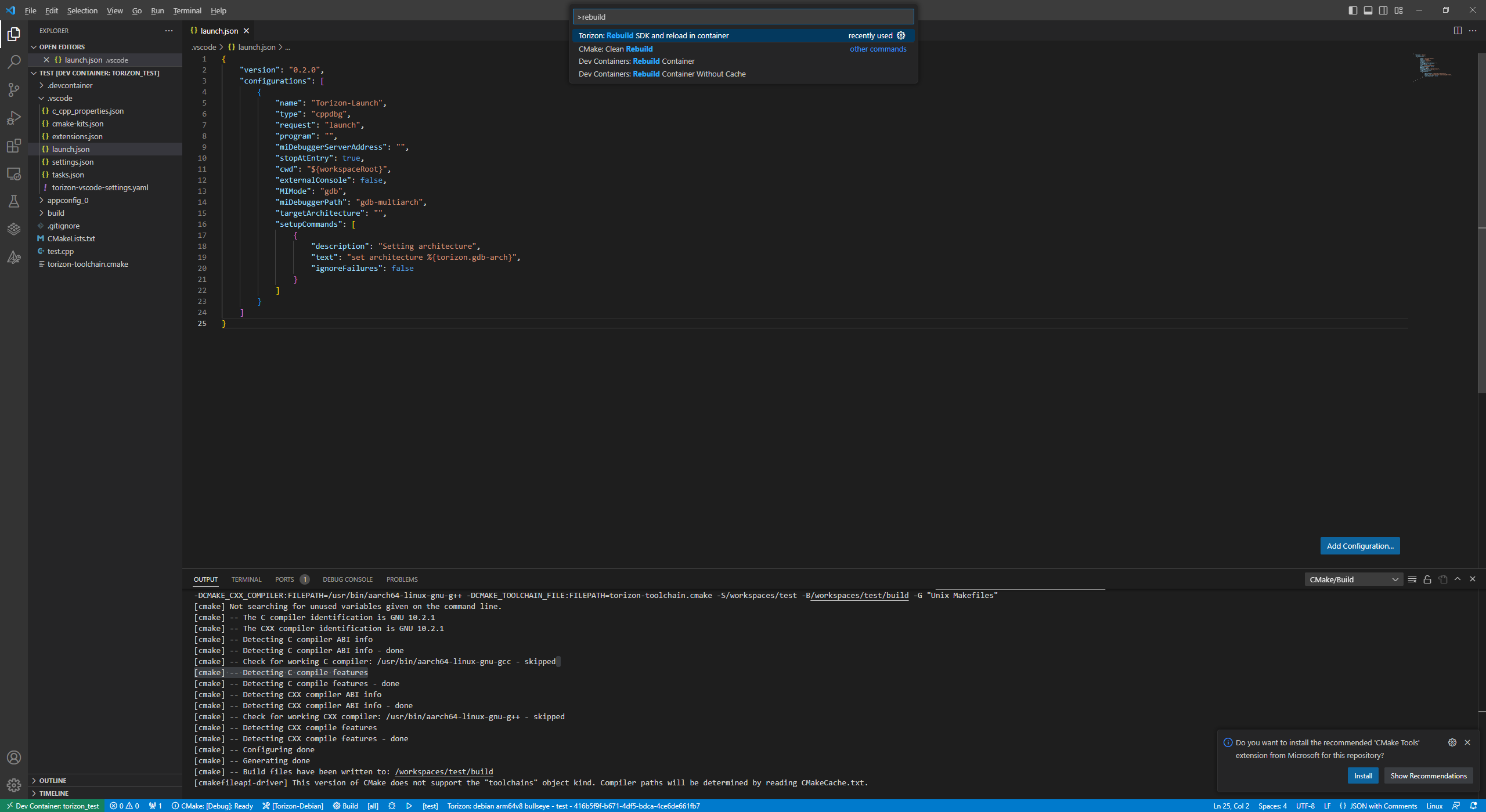

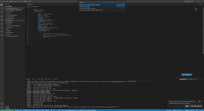

Wait so after you re-opened the project in the SDK container does it resolve the original issue now?
Strange I see the option on my side here:
Looking at your screenshot however it appears that the Torizon extension isn’t up and running. Compare to my screenshot there should be a “Torizon:…” in the bottom part of VSCode to show that the extension is running. Perhaps this is the root cause of the issues here and why your project didn’t automatically run inside the SDK container?
