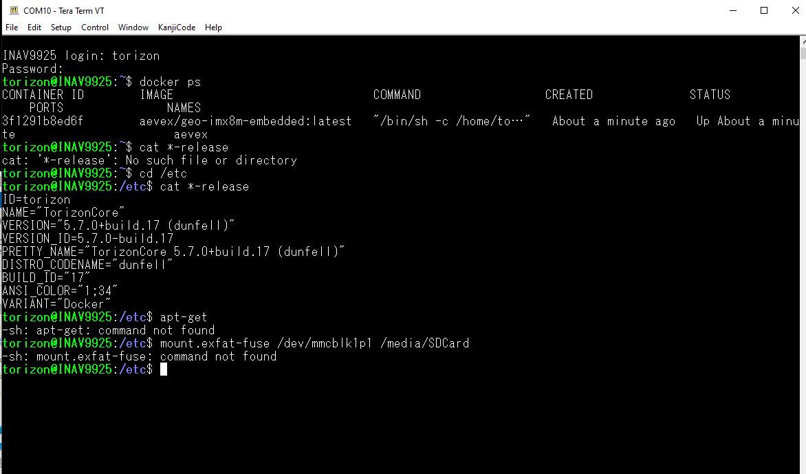

Hello, I was trying to implement scripts to shutdown a Verdin iMX8M Plus from a container. I installed the wait_for_shutdown_service and was trying to write to the shutdown_signal file and somehow I’ve lost mount and apt commands. When I reboot the container still starts and I can access an exfat flash from the container but I can’t access it when I log in from teraterm and I’m logged in as torizon. I tried to run mount and realized I don’t have mount and then I realized I also don’t have apt. I’ve tried rebooting and completely powering down. Do you have a suggestion for how to get them back? Do I need to reinstall the OS?

The apt and mount.exfat-fuse are Debian based packages/tools. You can access these while inside the container because the container is Debian based with the packages installed. So if you need to use these commands, you’ll need to make sure its on a Debian based container. Here is our supporting documents on it: Debian Containers for Torizon
When you SSH into the module (teraterm/torizon), your on Torizon OS that doesn’t natively support these packages(Debian). So reinstalling the OS won’t achieve this. They are not there or install-able.
If the goal is to access the flash from the container and permanently save/access information outside of the container. You will need to add the flash drive device to the container and create a volume for it via docker. This can be done either in the docker-compose file or on the command line when you docker run you can add --device and -v flags.
