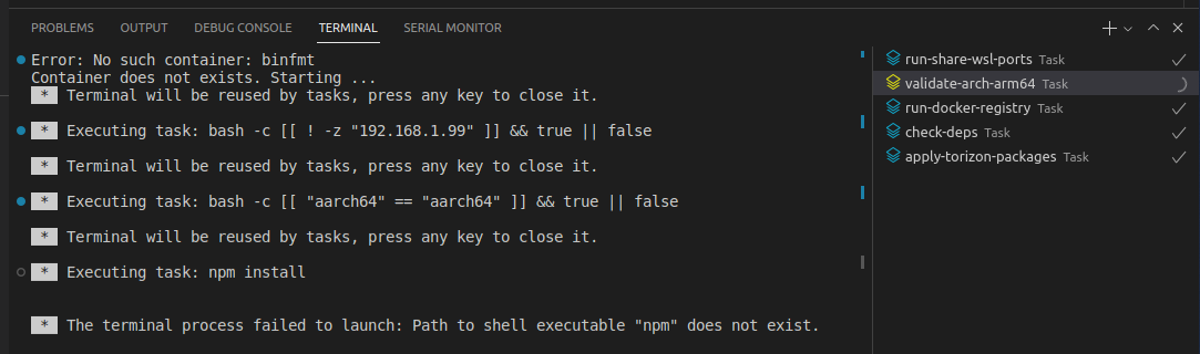

I installed ApolloX on my Ubuntu 22.04 machine (Virtualbox Guest OS) and I followed the documentation here.
I created the project from template TypeScript / Node.js
I clicked yes when asked to search for dependencies, and it seems everything is ok.
If I try to Compile and Debug as described here I see the following errors:
With the command docker image ls from the terminal , I see the image
torizon/binfmt latest 893244d86992 2 years ago 37.5MB

The output is
npm:
It seems that npm is not installed on my Ubuntu machine.

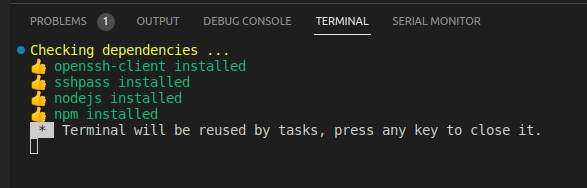

But the dependency check of ApolloX said it’s installed.
The templates are open source, the public repo: GitHub - torizon/vscode-torizon-templates: VS Code Torizon Integrated Development Environment Templates
The script that checks for dependencies:
https://github.com/toradex/vscode-torizon-templates/blob/main/scripts/checkDeps.ps1
You can note that this check if the apt package is installed, for the NodeJS Typescript project the npm package.
Could you also try and report the result?:
dpkg -s npm

I notice that the line
Status: deinstall ok config-files
seems suspicious.
For a package that is installed (git) the same line is
Status: install ok installed
So it seems that npm is not installed completely.
I launched sudo apt-get install npm and after I get positive results:
  • whereis npm returns the location of npm
  • dpkg -s npm returns Status: install ok installed
  • the project compiles and ssh connection to the device is started (then I see other errors, but I will open a different topic)
