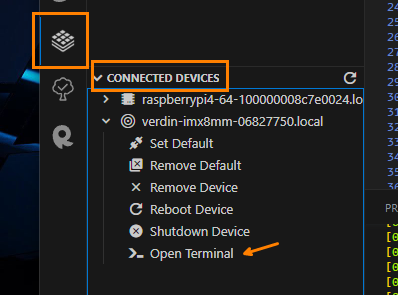

Hi @SimonBaur
could you check the version of the extension that you are using?
Should be version 0.0.66
Also check if it is possible to connect to the default device using the Open Terminal option:
Another test is to try to connect using your system terminal directly tiping the password when required:
ssh torizon@<your device hostname or ip>
Let me know if it’s possible to connect in these other ways.
