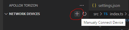

ApolloX in WSL has some issues seeing a connected Verdin (see this discussion), but if the Verdin has an IP address assigned by DHCP, I can connect to it from VS Code using “Manually Connect Device”
But if the Verdin has a static IP address, I cannot connect using “Manually Connect Device” because I get the error
