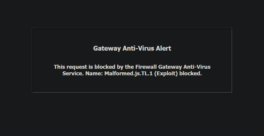

Hi Max,
Thanks for the quick response, I really appreciate your help. I tried a wget as well and it cuts the download short. Turns out our firewall does not like Mozilla’s FTP! I suspect this is the root of the issue, thank you very much for bringing this up, and for pointing to the trouble shooting section. I should have tried the suggestions
first (though it wouldn’t help here). I did a bit of googling but overlooked that section.
I’ve contacted our IT dept to get the proper access allowed for the build VM, I think the toolchain will work once we sort this out.

thanks for this input. had the same problem solved by switching to another network where link is not blocked.
