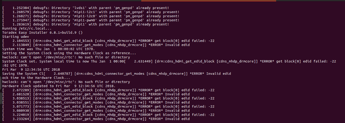

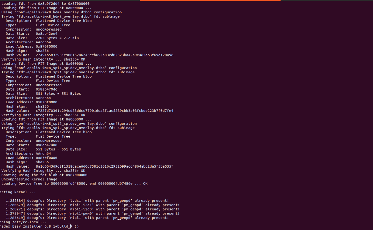

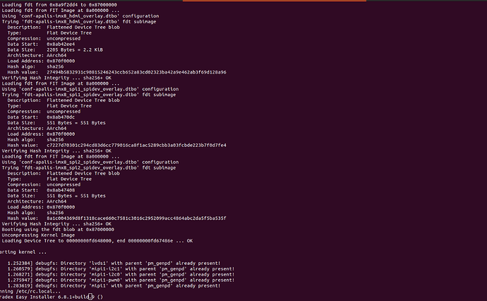

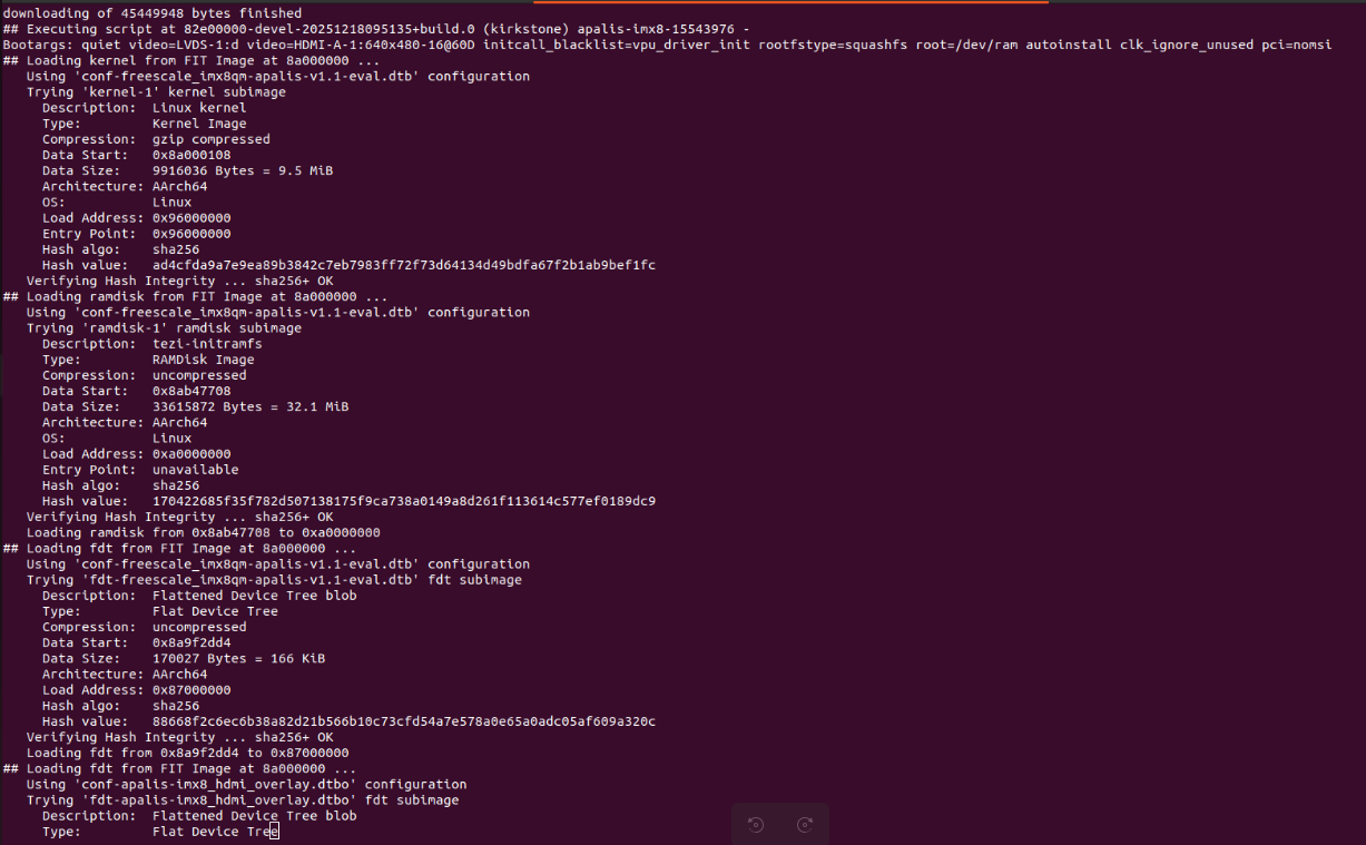

im using apalis imx8qm and im working on loading a fit image, the problem is i find some nodes that i did not include in my .its like initramfs node and other .dtb,dtbo.

Greetings @anmsn44,
That’s the FIT image for Toradex Easy Installer not for your image. Toradex Easy Installer gets loaded onto the device via FIT image. This is different and separate from your final OS.
yes but is it supposed to have an initramfs node in every image or is this something wrong with my image because as you can see my .its does not have any even the dtb nodes are not the same, even the configuration chosen is not the same as what u boot displays, so any idea whats wrong with my image
I believe you have a misunderstanding regarding what you are looking at.
The screenshots you took show the boot logs for Toradex Easy Installer. You can see this in the logs themselves. Toradex Easy Installer has it’s own FIT image that is different than your FIT image. These are not the same things, you are comparing two different pieces of software.
But why is toradex fit image is in my image isnt supposed to have my own fit image which i have built and i can see it in the deploy dir
Are you sure you actually flashed your image to the device?
In your very own screenshots that you provided at the start of this discussion you can see that this device is running Toradex Easy Installer. Not whatever image you built. Look at the last screenshot it even says Toradex Easy Installer 6.8.1.build.9.
I think you’re mistaken on what software is currently running on this device.
