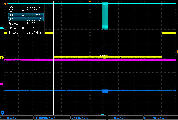

The result on oscilloscope: only one of the chip selects is working with a big delay (dmesg.log is in attachements)dmesg.log. (In addition the native chip select goes low with every byte sent.)
Oscilloscope images:
[upload|1t5z4IdE4MLycrgtfUDWfd+Elt0=]
zoom in:
[upload|GXBbDw0sl8tl2csq40mE6g7Gzu0=]
linux version: Linux apalis-imx8 4.14.117
is there something I should change in the device tree?.

Hi @majd.m
Yes, we can reproduce the issue. We are looking for the root cause of this issue. Once we have more Information, we will come back to you.
Jaski
A fix for this has been merged here:
Hi @marcel.tx,
Thank you for your support. I updated the kernel to this commit and compiled it, then transfered the kernel (“Image” file) and the device tree for apalis board “fsl-imx8qm-apalis-eval.dtb” to the boot partition. First the module doesnt boot, because it searchs for “fsl-imx8qm-apalis.dtb” and cant find it. By changing the device tree to this name name. the kernel starts to boot but it gets kernel panic after it (with default device tree definitions)
When I use the old compiled device tree file the kernel boots, but i want to make some changes on the device tree.
Best regards, Majd
HI @majd.m
You should flash the latest nightly build ( Activate CI Feeds in Toradex Easy Installer ) and then do a custom kernel with the patch. This should work.
Jaski
Hi @jaski.tx,
Thanks, I have done some workaround method and made it work. I tested 3 chip selects on SPI0 and seem to work, but the only remaining issue is the chip select speed.
There is a latency of about 35µs between selecting the chip and SPI transfer as well as after SPI transfer. Is it not possible to reduce this latency?
Thanks and Best regards,Majd
HI @majd.m
Perfect the Gpio Chip selects are working. Thanks for your feedback.
For the delay could ask a new question, please?
Jaski
