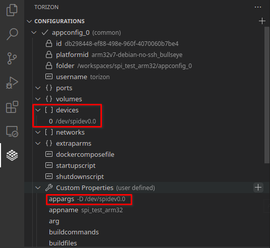

And it looks like you’ve added /dev/spidev0.0 in devices in our extension configuration options.
Did you add the appargs custom property as instructed by the article? You have to add it by clicking on the ‘+’ icon on the right of Custom Properties (user defined).
Your configuration options should be similar to this:
Note that I’ve used an Apalis iMX6, but the highlighted options should be identical for your case.
Try running the test code after this and let me know if it helps you.
