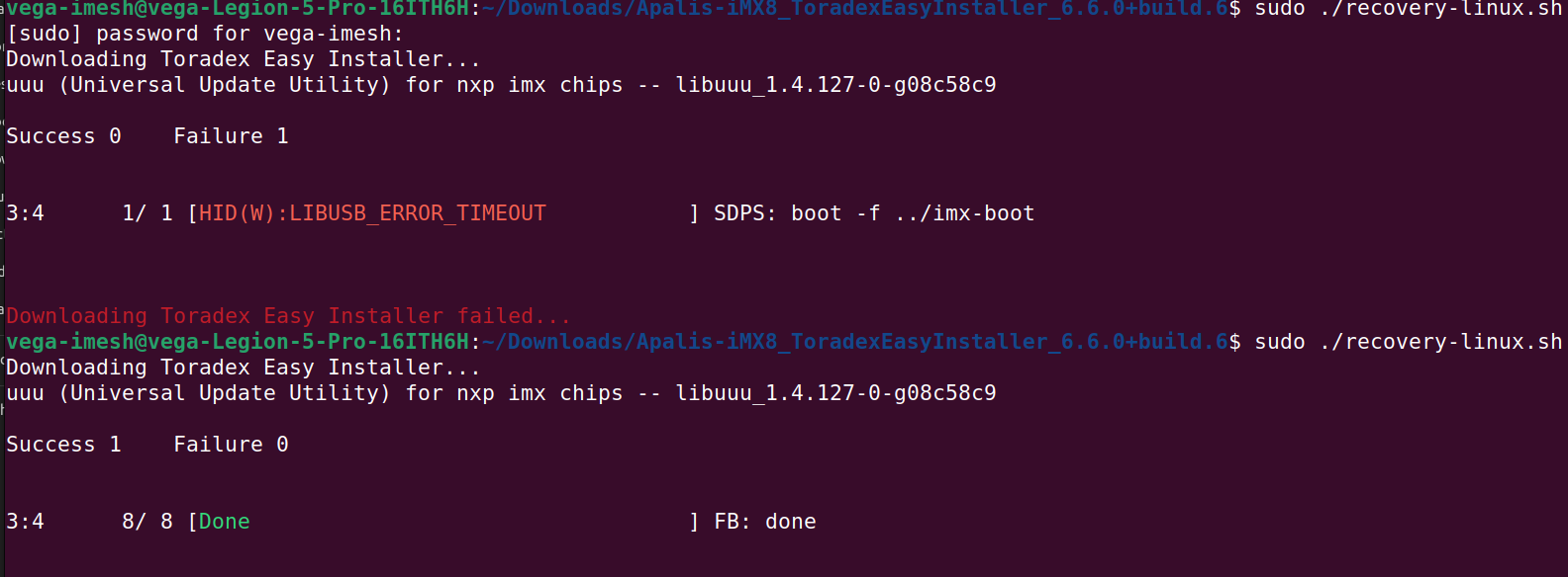

I have an Apalis iMX8 QuadMax 4GB Wi-Fi / Bluetooth IT with Ixora V1.1A running a Qt application. It was working fine but yesterday, the board was not booting. I checked by swapping SoM and carrier board. The carrier board seems to working fine with another iMX8 module and the iMX8 module is not working.
I tried to get it into recovery mode but I’m getting HID(W):LIBUSB_ERROR_TIMEOUT error. Can you help me with debugging this issue and identifying the problem with this?

Thanks for getting back. I’m able to load the Toradex Easy Installer to the functioning module. Below I’m sharing a screenshot of the first trying the module with the problem and after that the functioning one.
How can I debug further to identify what is the cause of this issue?

It looks like your “bad” module was configured for secure boot. Have you tried changing any fuses?
No. Can you please guide me on that?
If you wish to enable a secure boot please follow this document:
If you haven’t changed any fuses but recovery is not working, it is likely that your module was damaged. Please fill out this RMA form to initiate the RMA process:
