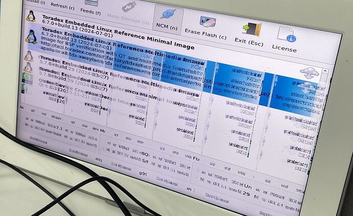

While booting the Toradex easy installer from SD card.it is showing like this error.
Used version of Toradex easy installer : 6.5.0+
Through this installer I had installed the image shown in the GUI display. After that the error encountered.

I had installed Toradex easy installer image to the SD card after creating FAT32 partition.(version 6.5.0+)
Then did the booting process upon which list of images where shown in the HDMI display. From those I selected image shown in the attached file and it was successfully installed. But after the installation I rebooted the system and got the error above and couldn’t complete the booting process.

Since you are booting Toradex Easy Installer,from SD Card please remove the SD card after installation process is complete.
Also, did you try to install other image to check whether the issue is happening on one particular image or other images as well.
Also, it would be better if you could share a clear picture.
