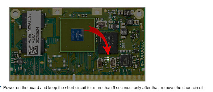

And one more module is not showing these logs also, unable to figure out if the board is gone bad or what
I have gone through the recovery steps from the following link, however I do not have Mezzanine daughter board. Does the evaluation board itself has any recovery button which is similar to what Mezzanine board has it.
Let me know how do I recover from this state.

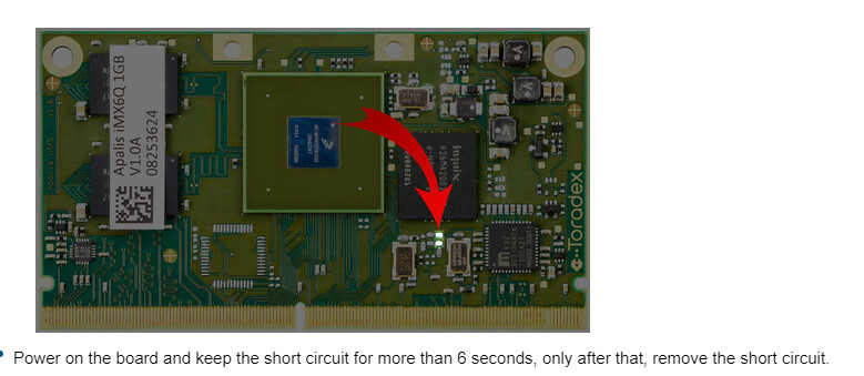

You can always use this method to enter recovery mode -
