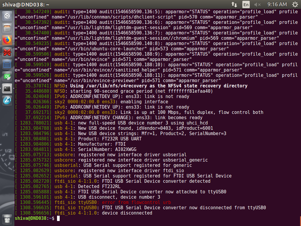

it not working ,two pads shorted and using usb01 to host computer connection is not establishing and showing “error from flow control urb” see the below picture as reference .
give me some suggestion to boot my board in recovery mode.
