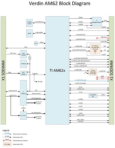

The 4 analog inputs that the summary mentions are provided via an external TLA2024 ADC, as you can see in the the block diagram
Josep
Dear Josep,
Thank you for the quick response.
Sadly this ADC is really slow (3.3ksps) therefore we still have to switch to an external ADC, but this explains the differences.
