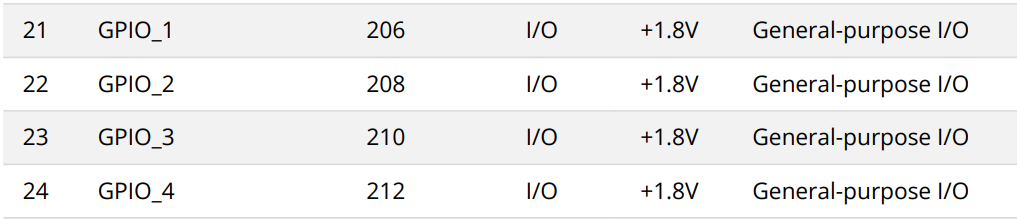

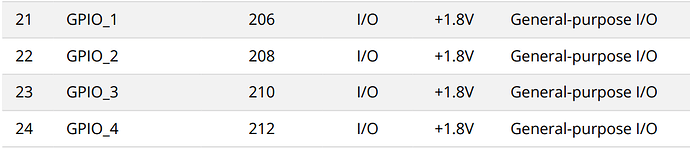

From what I could gather, you want to use the following gpios, which can be found in the Mallow datasheet:
This means, that you will want to use SODIMM pins 206, 208, 210 and 212.
If you are successfully able to toggle those pins, you can use the gpio-toggle.c file as a template for your C application.

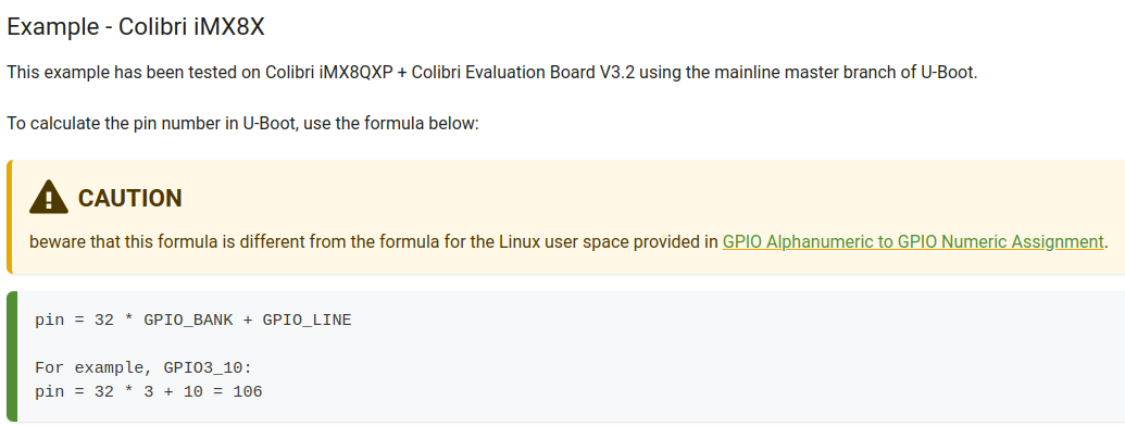

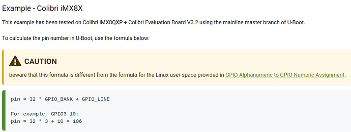

For example, on other boards, there is a computation like this :
pin = 32*3+10
If I were able to have this info for my AM62 board, I should only need to adapt the pin number into the sheel script to export the gpio 1 2 3 4 pins (sheel script is here: sx1302_hal/tools/reset_lgw.sh at master · Lora-net/sx1302_hal · GitHub ).
If not, i would change the driver code.

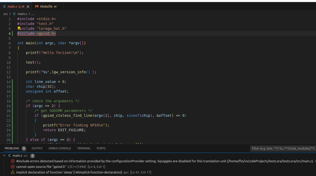

I need to integrate in my C template the C gpio docker file content to control the gpio in my main.c
I have just an issue even if i add to torizonpackage and linker -lgpiod
I wonder how this header can be detect by my host system on vs code if it is not installed on it but installed via the docker.
So should I install gpio on my host pc to avoid it ?
I understand that toradex push to use docker method to work, but sometimes i have the feeling that we spend more time on this than our real application :sweat_smile:

This problem is more of convenience and ease of use, as the header is not actually missing when the code is built on the docker container.
Your workaround to install the development libraries on your PC is a valid one and should solve the problem.
