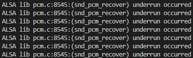

			frames = snd_pcm_recover(PlaybackHandle, frames, 0);

Handling EAGAIN now allows the sound to be played for longer, which is progress! However, it is now stuttering at every X frames (I’m guessing EAGAIN happens very often and creates some sort of underrun?). For example, if my audio file is 10 seconds long, the code will only play the first 5 seconds, but spreaded over 10 seconds with stutters in between (the stutters last the same amount of time).

The sound effect of the underrun does not seem to change upon modifying the bufferSize. I’ve tried 512, and tested all the way up until even WaveSize value (300K+). Difference now is that I hear the whole 10 seconds, but with stutters. Am I changing the buffer size correctly?
