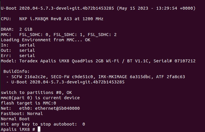

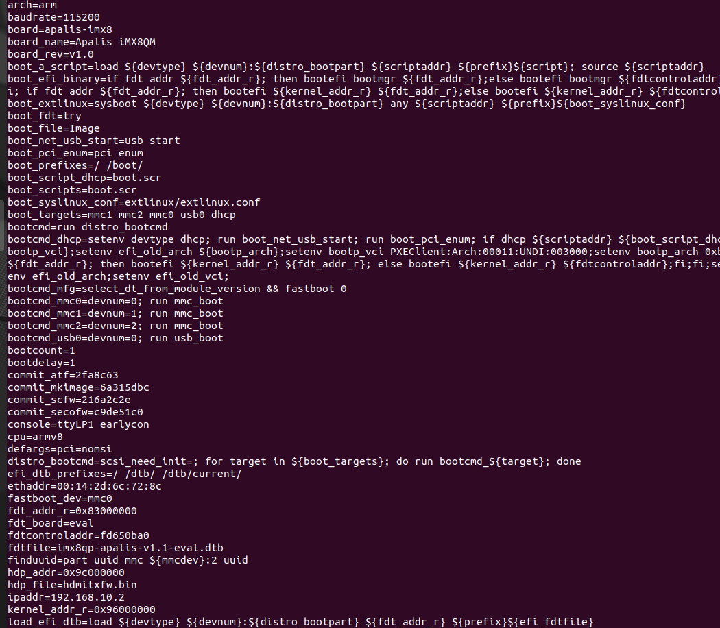

  1. uboot printenv

When you flashing new image, the existing env settings are override. What you need is to add the MAC setting to u-boot environment and then flash. You will need to generate new image. Please check below post which explain how to append change with yocto
Ritesh Kumar
