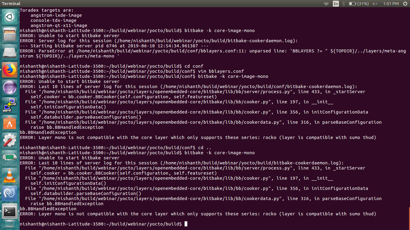

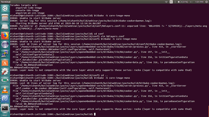

I tried to add mono layer into my image using yocto project and i followed this link and it ran into errors and i have attached the screenshot of those errors.

There was a missing " in your conf/bblayers.conf file. Looks like you corrected that in a later stage.
The error message bitbake gives tells you that the branch you checked out of meta-mono is not compatible with rocko. It is meant for a ‘sumo’ or ‘thud’ based installation.
As meta-mono has no rocko branch you could try one of two approaches:
a)
Check out the ‘pyro’ branch of meta-rocko and try to build.
b)
Modify the meta-mono/conf/layer.conf file. Add rocko to the list of compatible layers.
