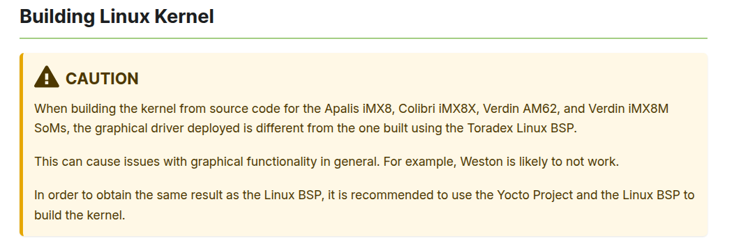

@cli ,
When building kernel from source code and deploying it to Apalis iMX8, graphical functionality may not work as the original bsp. Ref: Build Linux Kernel from Source Code | Toradex Developer Center
You could change kernel config from Yocto Project and rebuild the image.
bitbake -c menuconfig virtual/kernel
Ref:Build a Reference Image with Yocto Project/OpenEmbedded | Toradex Developer Center
