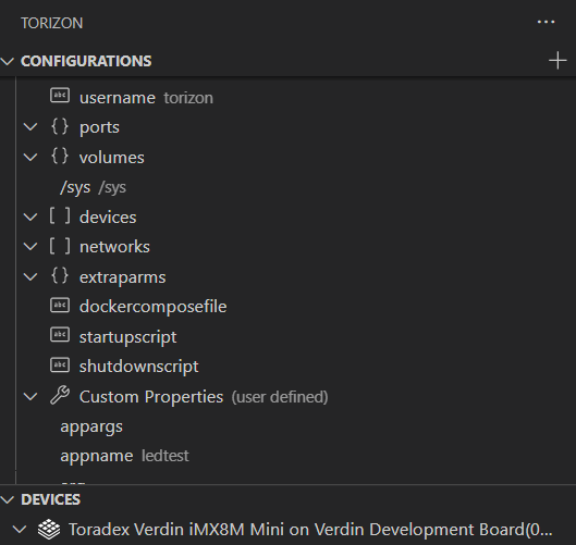

Hi Jeremias,
I’ve mapped the /sys volume to /sys in my container using the VSCode extension:
I’m still getting the same error:
Actually it appears you’re getting a different error now. Before you were getting Read-only file system but now it’s a Permission denied error.
