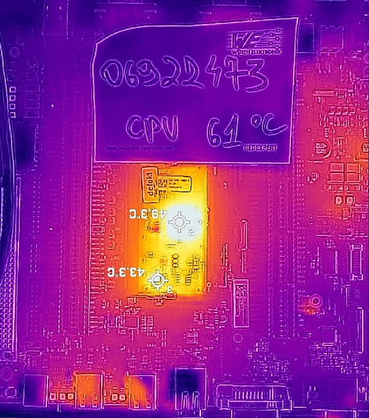

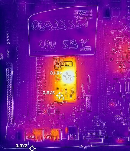

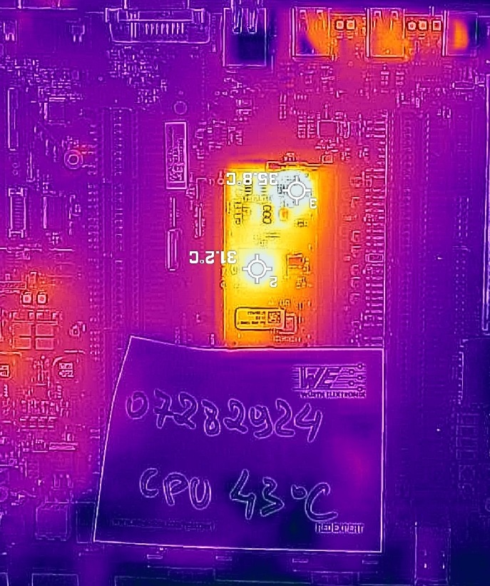

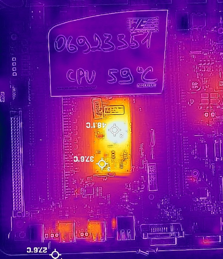

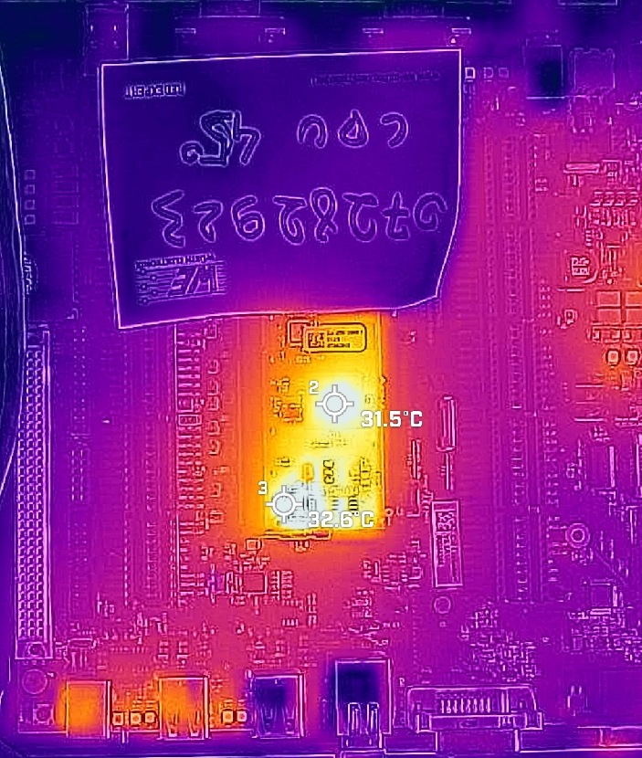

We are producing a series of measurement devices based on Colibri VF50 IT using our custom baseboard. Suddenly we found that some SoMs have significantly (like +20 °C) higher CPU temperatures than others. Fortunately, there are just some of them (I have 3 modules right on my table).
Our assumption that we can have a HW problem on our custom carrier boards or… it may be related to Colibri VF50 SoMs themself (but I do not think so).
Maybe you can give me some advice on how I can find a reason for higher CPU temperatures?
Here a list of SoM S/Ns a and according CPU temperatures, measurements are done using exactly the same carrier board and exactly the same FW and configuration:
07283226 45°C *
07283223 45°C *
07283224 44°C *
07282922 41°C *
07282923 45°C *
07282924 43°C *
07282929 44°C *
07282927 44°C *
07283227 44°C *
07283230 43°C *
dad one:
06923351 59 °C
06923417 62 °C
06922473 61 °C

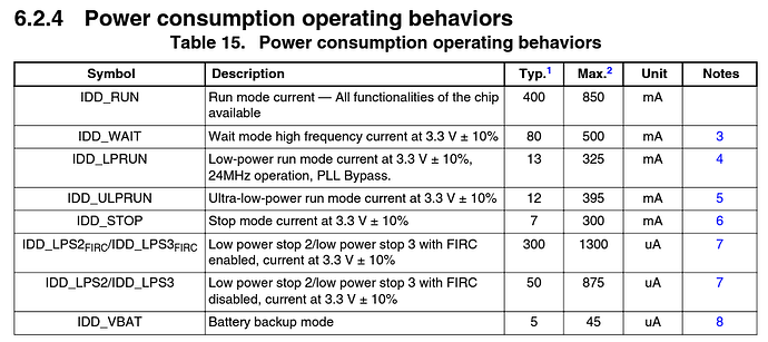

Here some pictures:
