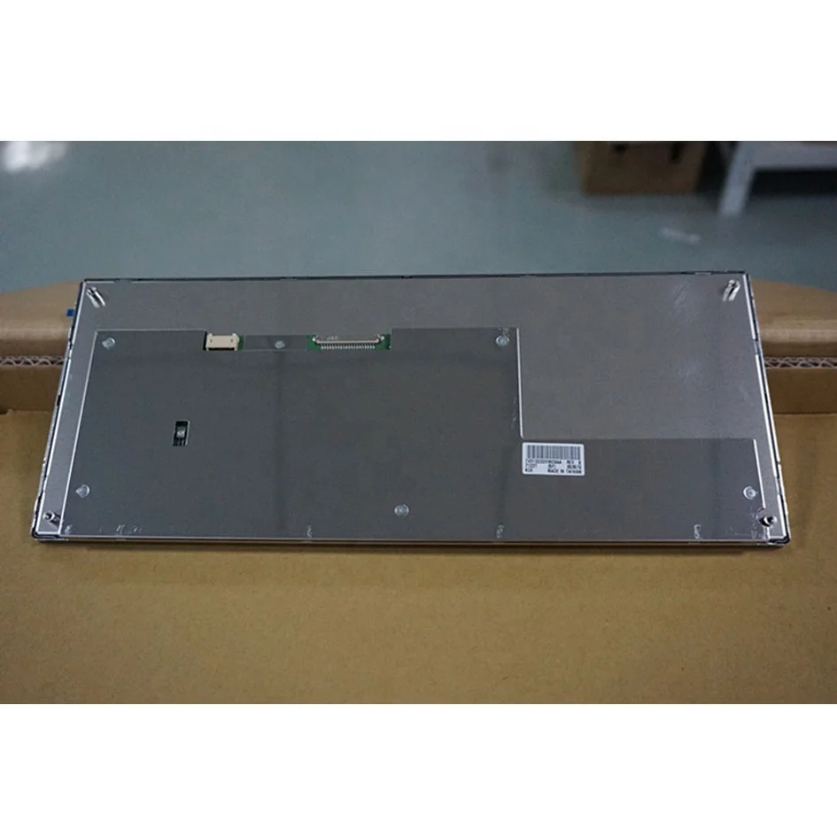

Dear @W0JTEK,
After digging around we found out that it was KOE 1280x480, something similar to this:
I was told that a dedicated LVDS cable was built for the demo. Regarding the overlay of this display I was unable to find anything unfortunately. If you acquire the datasheet of the display you will use however you can use the values given within for the overlay.
