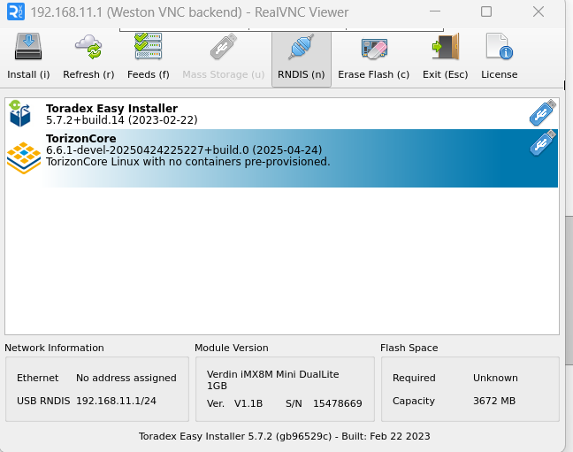

Hello Toradex Communiity. I’d like to ask for your help with a visible issue we’re having with a module. We recently send to produce our device with the Verdin IMX8MM DL 1GB V1.1B., and while doing our checklist revision with the devices, we noticed one of them hadn’t an IP address. I removed the module and checked it with he development board, and indeed the module was the issue. Initially i thought that it was a HW issue, however i noticed the Ethernet port IS linking between the board and the switch node.
I re programed it again with the Easy Installer, and tried to change this configuration manually with no success. Does any of you have an idea of what could it be?
The SO image. The ethernet shows No address asigned

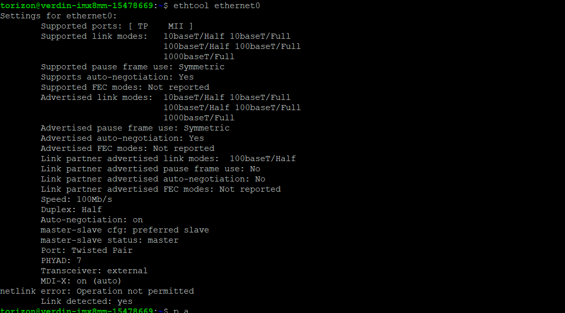

torizon@verdin-imx8mm-15478669:~$ ethtool ethernet0
Settings for ethernet0:
        Supported ports: [ TP    MII ]
        Supported link modes:   10baseT/Half 10baseT/Full
                                100baseT/Half 100baseT/Full
                                1000baseT/Full
        Supported pause frame use: Symmetric
        Supports auto-negotiation: Yes
        Supported FEC modes: Not reported
        Advertised link modes:  10baseT/Half 10baseT/Full
                                1000baseT/Full
        Advertised pause frame use: Symmetric
        Advertised auto-negotiation: Yes
        Advertised FEC modes: Not reported
        Link partner advertised link modes:  100baseT/Half
        Link partner advertised pause frame use: No
        Link partner advertised auto-negotiation: No
        Link partner advertised FEC modes: Not reported
        Speed: 100Mb/s
        Duplex: Half
        Auto-negotiation: on
        master-slave cfg: preferred slave
        master-slave status: master
        Port: Twisted Pair
        PHYAD: 7
        Transceiver: external
        MDI-X: Unknown
netlink error: Operation not permitted
        Link detected: yes

The link is coming up at 100 Mbps half duplex, which means auto-negotiation is not completing. That can come from the switch port being set to a fixed speed and duplex, or from a fault on the module transmit side. A manufacturing defect is possible, but the tests below are needed to tell the two apart.

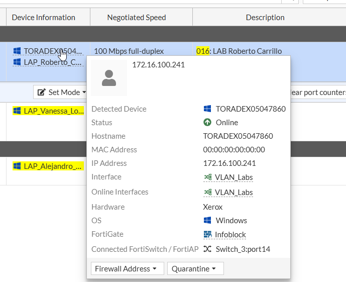

I was able to run the testing you shared. Our IT team is working on al the switch/node regarding information.
He shared me the MAC addres table of the port I am using, and it shows like this.
It appears that the MAC addres is nowhere to be shown.

Then with the autoneg -off, and ethtool output again
torizon@verdin-imx8mm-15478669:~$ sudo ethtool -s ethernet0 autoneg off speed 100 duplex full
Password:
torizon@verdin-imx8mm-15478669:~$ sudo ethtool ethernet0
                                1000baseT/Full
                                1000baseT/Full
        Advertised auto-negotiation: No
        Speed: 100Mb/s
        Duplex: Full
        Auto-negotiation: off
        Port: Twisted Pair
        PHYAD: 7
        MDI-X: Unknown
        Supports Wake-on: g
        Wake-on: d
        Link detected: yes
There is still no traffic after this:

As I sahred with you previously, I´ve already tested with othter modules on the same switch port, and is working properly.
I did the last test with a Cat6 cable, using the static address on both sides, same result

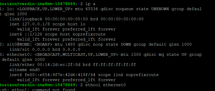

I still have the same static IP address assigned on the module
torizon@verdin-imx8mm-15478669:~$ ip a
1: lo: <LOOPBACK,UP,LOWER_UP> mtu 65536 qdisc noqueue state UNKNOWN group default qlen 1000
    link/loopback 00:00:00:00:00:00 brd 00:00:00:00:00:00
    inet 127.0.0.1/8 scope host lo
       valid_lft forever preferred_lft forever
    inet6 ::1/128 scope host
2: sit0@NONE: <NOARP> mtu 1480 qdisc noop state DOWN group default qlen 1000
    link/sit 0.0.0.0 brd 0.0.0.0
3: ethernet0: <BROADCAST,MULTICAST,UP,LOWER_UP> mtu 1500 qdisc mq state UP group default qlen 1000
    link/ether 00:14:2d:ec:2f:8d brd ff:ff:ff:ff:ff:ff
    inet 172.18.100.199/24 scope global ethernet0
4: docker0: <NO-CARRIER,BROADCAST,MULTICAST,UP> mtu 1500 qdisc noqueue state DOWN group default
    link/ether 02:42:e4:9a:bb:a4 brd ff:ff:ff:ff:ff:ff
    inet 10.88.1.1/24 brd 10.88.1.255 scope global docker0
As far as I can see, the switch node is discarted, and the module appears to have an issue correct?
