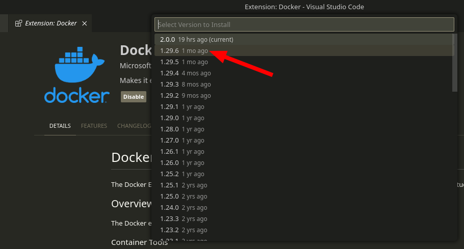

Could you please downgrade your Docker extension to version 1.29.6 and try again?

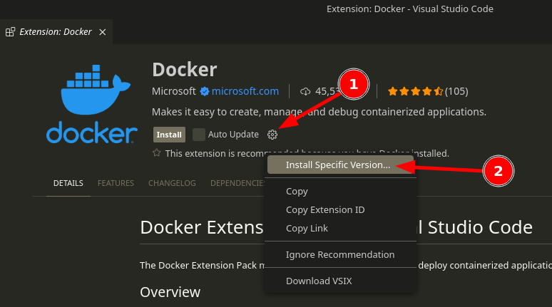

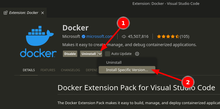

Here are some screenshots to serve as a guide.
If Docker extension from Microsoft is already installed:
If Docker extension from Microsoft is not already installed:
Then select the version 1.29.6:
Then trigger a Reload Window.
