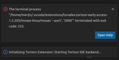

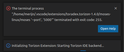

/home/merijn/.vscode/extensions/toradex.torizon-1.4.0/moses-linux/moses '--port', '5000'" terminated with exit code: 255.
No image is transferred to the connected Verdin module and (obviously) no container is created.

Ubuntu 22.04 is currently not supported on the Visual Studio Code Extension. There was a package conflict between the last releases of Ubuntu and the new LTS that we’re working on to get everything on point for customers.

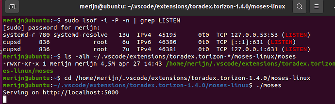

However, as you said that you’re trying at first on Ubuntu 20.04.4 LTS, I’d like you to do two things:

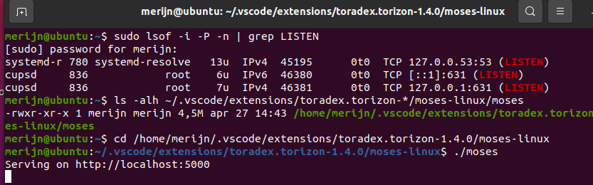

  1. Can you please check that no application is using port 5000 on your PC when you try to open the extension? You can do this by typing: sudo lsof -i -P -n | grep LISTEN. If there is something that appears, it may be causing a conflict with the extension backend.
  2. If there is anything that show up, can you please try to run moses separately and give me any log that pops out? You can find the path to moses by typing: ls -alh ~/.vscode/extensions/toradex.torizon-*/moses-linux/moses
Guilherme
Everything is working as it should…
That’s good to hear!
So can you please interrupt Moses and try to open the extension again to check if the following error stops appearing?
About the new error that appears, can you please try to press F1 and run the following command: Developer: Reload Window and tell me if the error appears again when you try to rebuild again?
Guilherme
After running “Developer: Reload Window” I was able to get things running again, but it was a lucky shot. I closed VSCode to do the test again and didn’t succeed after three tries.

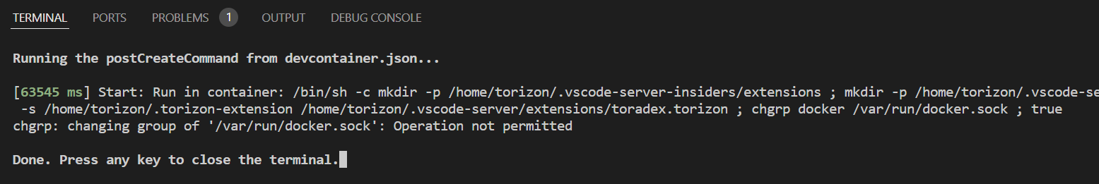

Now, when I open my project folder and run “Toradex: Rebuild SDK and reload in container” I get
Running the postCreateCommand from devcontainer.json...
[3799 ms] Start: Run in container: /bin/sh -c mkdir -p /home/torizon/.vscode-server-insiders/extensions ; mkdir -p /home/torizon/.vscode-server/extensions; ln -s /home/torizon/.torizon-extension /home/torizon/.vscode-server-insiders/extensions/toradex.torizon ; ln -s /home/torizon/.torizon-extension /home/torizon/.vscode-server/extensions/toradex.torizon ; chgrp docker /var/run/docker.sock ; true
chgrp: changing group of '/var/run/docker.sock': Operation not permitted
Done. Press any key to close the terminal.
Dear @mvandenabeele ,
This is a current bug that has started to happen on the extension recently after a new VS Code Update. We’re currently working to get fixed. As from today, it could be nice to check if you can see Torizon Logo on the left-side of your VS Code as in the screenshot below.
If it shows there, you should be able to run the command that you wish to. However, if you can’t see the logo or if you get the same error message again, the current workaround is to do the Developer: Reload Window once more.
We can get back to you once the bug is fixed if you wish to.

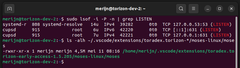

Running the commands you asked me to run in the beginning gave me this output:
This is on a fully updated Ubuntu 22.04 with VS Code 1.67.1

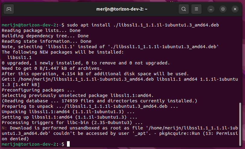

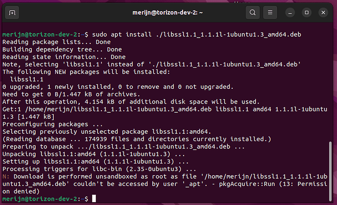

BTW. The link to libssl1.1l in the installation instructions should be http://security.ubuntu.com/ubuntu/pool/main/o/openssl/libssl1.1_1.1.1l-1ubuntu1.3_amd64.deb I think. The current link gives a 404. Running the install command however gave
I’m not sure if that went okay.

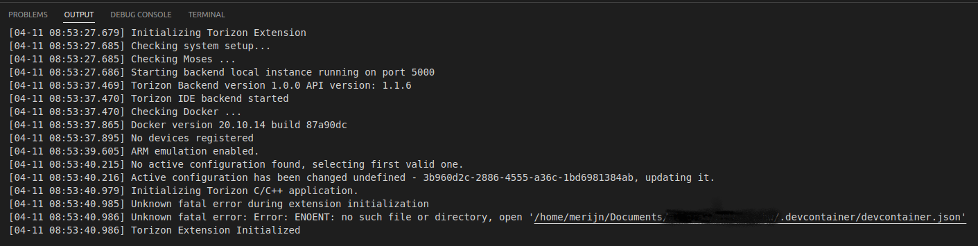

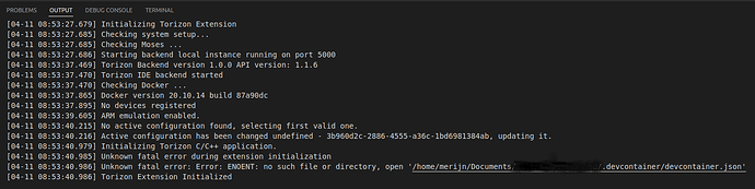

And because I desperately want to get working on our project, I tried creating a new project in a Windows environment. This gave me
I saw this error on Ubuntu too.

This issue is linked to an error on the devcontainer.json file. Can you please follow the steps on the video below to check if you can get things back running? Remember to use the Easy Installer Early Access Extension.
Guilherme
When I did this in my newly created project, it started working. My old project didn’t even have a .devcontainer and the .vscode folder was missing most files too. I copied the missing files from the new working project and now it does look a lot better. I’m still having issues with CMake not behaving as it used to, but I’ll look at that today.

Also, the URL to download libssl is changed in the wget command, but not in the next command where the package should be installed. Please note, as stated before, that the installation ends with an error. I’m not sure if it’s a big problem. It doesn’t matter too much as I can’t get it to work in older Ubuntus either.
