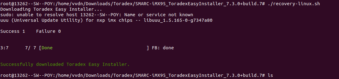

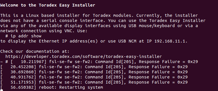

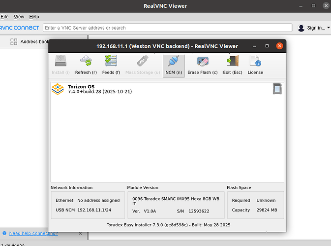

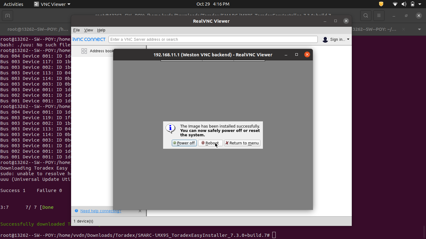

We are working on the SMARC iMX95 EVK. Here we are using the SD and EMMC booting mode. SD card is working fine but in the EMMC we are facing the reboot issue. We have successfully loaded the toradex easy installer using the linux system and with the default ip 192.168.11.1 we have used the vnc viewer for loading the torizon os that is present in the SD card. After the successful image loaded if we gives reboot means it will be hanged and there is no booting done. The default eMMC image also not booted, from the eMMC, no image have been booted if we open the minicom terminal, it is hanged still there no logs after we given the reboot in vnc viewer. What is the issue? How to recover this and boot our image with the eMMC? Attaching the screenshot for your reference.

It looks like you tried to flash the latest 7.4.0 image on a version 1.0A SMARC i.MX95. These are not compatible. Our latest OS software was built for the newer SMARC i.MX95 which uses a different silicon version on the i.MX95 SoC. This new silicon requires new/different software and is not compatible with the old silicon.
If you want to flash Torizon OS on the older silicon you do have, you need to use OS version 7.3.0.

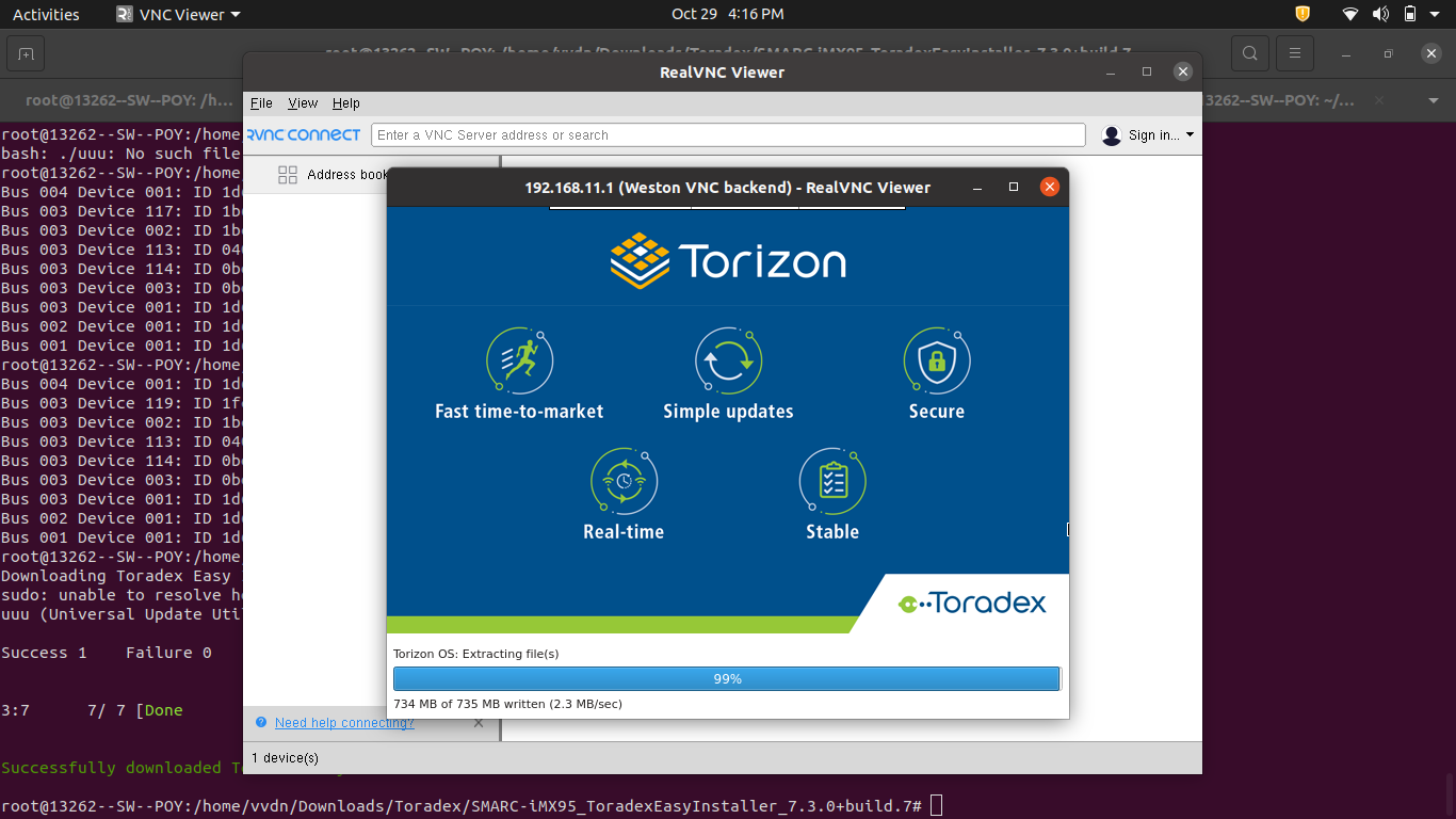

Thank you for the response. Here we have flashed the torizon os 7.3.0 version in the board using the toradex easy installer, but if we flashed the SMARC-iMX95_Reference-Multimedia-Image-Tezi_7.5.0-devel-20251029071517+build.0.tar (SMARC-iMX95_Reference-Multimedia-Image-Tezi_7.5.0-devel-20251029071517+build.0) means, it is also not working. For the EMMC flash it is not rebooting, same issue. We are using the 7.5.0 for reference and 7.3.0 for torizon. If we use the 7.5.0 reference image means the SD card booting also not working.Which version of image for both the reference and torizon will be supported for the emmc and SD card. If the uuu will be work on the smarc imx95. Kindly support on this?
