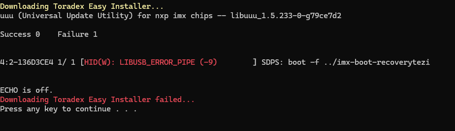

I ran the following script:
recovery-windows.bat
The output is:
uuu (Universal Update Utility) for nxp imx chips -- libuuu_1.5.233-0-g79ce7d2
Success 0    Failure 1
2:1-3AA9187E 1/ 1 [HID(W): LIBUSB_ERROR_PIPE (-9)]
SDPS: boot -f ../imx-boot-recoverytezi
Downloading Toradex Easy Installer failed...

  1. I tested multiple USB 2.0 and USB 3.0 Type-C to Type-A cables.
  2. I verified the connection using multiple USB ports.
  3. I tested both with and without a USB hub.
  4. When the EVK is connected to Windows 11, it appears in Device Manager as a USB Input Device (is this the expected behavior?).
  5. In addition to Windows 11, I also tested on Ubuntu 22.04.
  6. Even when running uuu directly, it fails.
    PS C:\Users\MyUser\Desktop\SMARC-iMX95_ToradexEasyInstaller_7.4.0+build.8> .\recovery\uuu.exe recovery
    uuu (Universal Update Utility) for nxp imx chips – libuuu_1.5.233-0-g79ce7d2
    Success 0 Failure 1
    2:1-3AA9187E 1/ 1 [HID(W): LIBUSB_ERROR_PIPE (-9) ] SDPS: boot -f ../imx-boot-recoverytezi
