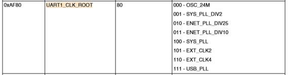

I spoke about 80 MHz since in the IMX7DRM document at chapter 5.2 Clock Control Module the UART1_CLK_ROOT must have a maximum clock frequency of 80 MHz.
