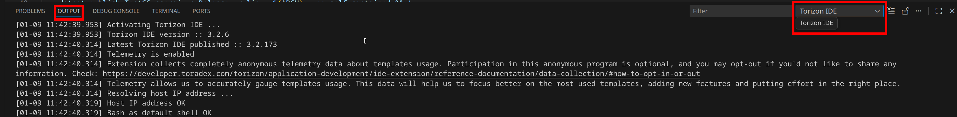

Hello @gerko,
Which task did you ran that generated the above logs?
Could you also send the logs present on the “output” tab for the IDE extension below?
Please make sure that Torizon IDE is selected on the drop down on the right side.
Bruno

Thanks @gerko,
Can you re-open the VSCode Window and send the logs from this output tab?
This way we can check the IDE Initialization logs to see if anything unexpected is happening.
Bruno
[01-09 12:08:12.539] Activating Torizon IDE ...
[01-09 12:08:12.540] Torizon IDE version :: 3.2.6
[01-09 12:08:13.504] Latest Torizon IDE published :: 3.2.173
[01-09 12:08:13.504] Telemetry is enabled
[01-09 12:08:13.504] Extension collects completely anonymous telemetry data about templates usage. Participation in this anonymous program is optional, and you may opt-out if you'd not like to share any information. Check: https://developer.toradex.com/torizon/application-development/ide-extension/reference-documentation/data-collection/#how-to-opt-in-or-out
[01-09 12:08:13.505] Telemetry allows us to accurately gauge templates usage. This data will help us to focus better on the most used templates, adding new features and putting effort in the right place.
[01-09 12:08:13.505] Resolving host IP address ...
[01-09 12:08:13.554] Host IP address OK
[01-09 12:08:13.555] Bash as default shell OK
[01-09 12:08:13.579] Docker installed OK
[01-09 12:08:14.051] Docker running OK
[01-09 12:08:14.151] Docker compose OK
[01-09 12:08:14.161] PowerShell OK
[01-09 12:08:14.199] git OK
[01-09 12:08:14.352] dig OK
[01-09 12:08:14.395] avahi-resolve OK
[01-09 12:08:14.434] nmap OK
[01-09 12:08:14.479] iputils-ping OK
[01-09 12:08:14.500] file OK
[01-09 12:08:14.542] sshpass OK
[01-09 12:08:14.721] iproute2 OK
[01-09 12:08:14.910] rsync OK
[01-09 12:08:15.217] python3 OK
[01-09 12:08:15.315] pipx OK
[01-09 12:08:15.315] Cloning project templates
[01-09 12:08:15.316] Templates repo: https://github.com/torizon/vscode-torizon-templates.git
[01-09 12:08:15.316] Templates tag/hash: v3.2.6
[01-09 12:08:15.333] Project templates clone of branch  OK
[01-09 12:08:15.733] Project templates fetched OK
[01-09 12:08:15.794] Checkout templates repo to tag v3.2.6 OK
[01-09 12:08:25.275] xonsh installation OK
[01-09 12:08:25.276] WARNING :: Project name not found in workspace metadata for single container workspace, or it matches the workspace name.
[01-09 12:08:25.277] Checking connected devices ...
[01-09 12:08:25.278] Scanning Torizon devices ...
[01-09 12:08:25.289] Debian bookworm packages list load OK
[01-09 12:08:25.290] Debug id_rsa OK
[01-09 12:08:25.335] Checking host ip sanity ...
[01-09 12:08:25.676] Torizon IDE extension activated
[01-09 12:08:26.680] Host ip is OK
[01-09 12:08:26.688] Device 10.100.1.79 set as Docker Host
