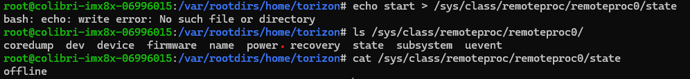

Hi @leonardo.costa.tx ,
I followed the instructions here and everything seems to be work as expected until I try to start the firmware by echoing “start” to /sys/class/remoteproc/remoteproc0/state. See what I get in the image below.
Surely I am missing something…

Hi @vic
I was able to run the M4 firmware today using remoteproc. Specifically, I am on the 7.4.0+build.28 release of Torizon. I modified my overlays.txt file as follows:
root@colibri-imx8x-06748684:/boot# cat /boot/ostree/torizon-77368a704b4e45bd6dc2d3539f6687f7be15979fb3249f06d8a2785f573fd6ea/dtb/overlays.txt
fdt_overlays=colibri-imx8x_vga-640x480_overlay.dtbo colibri-imx8x_hmp_overlay.dtbo colibri-imx8x_disable-cm40-uart_overlay.dtbo
Your OSTreee ID will likely be different than mine. I started with an unmodified quarterly build and make the changes manually. Eventually this should go into your torizoncore-builder config.
Then once I rebooted with that setup, I was able to do the following:
# echo -n /boot > /sys/module/firmware_class/parameters/path
# echo hello_world.elf >  /sys/class/remoteproc/remoteproc0/firmware
# echo start > /sys/class/remoteproc/remoteproc0/state
My guess is that doing this with remoteproc, rather than using the older method of the bootaux command in u-boot will allow you to proceed. I’ve not looked in depth at your code yet so it’s possible that something in there is clashing with Linux but since you indicated it seemed to be an issue on boot, hopefully running this using remoteproc, but after Linux is booted will, at the very least, unblock you.
I don’t know why your test with remoteproc failed but if you can share the entire set of commands maybe we can spot something.
