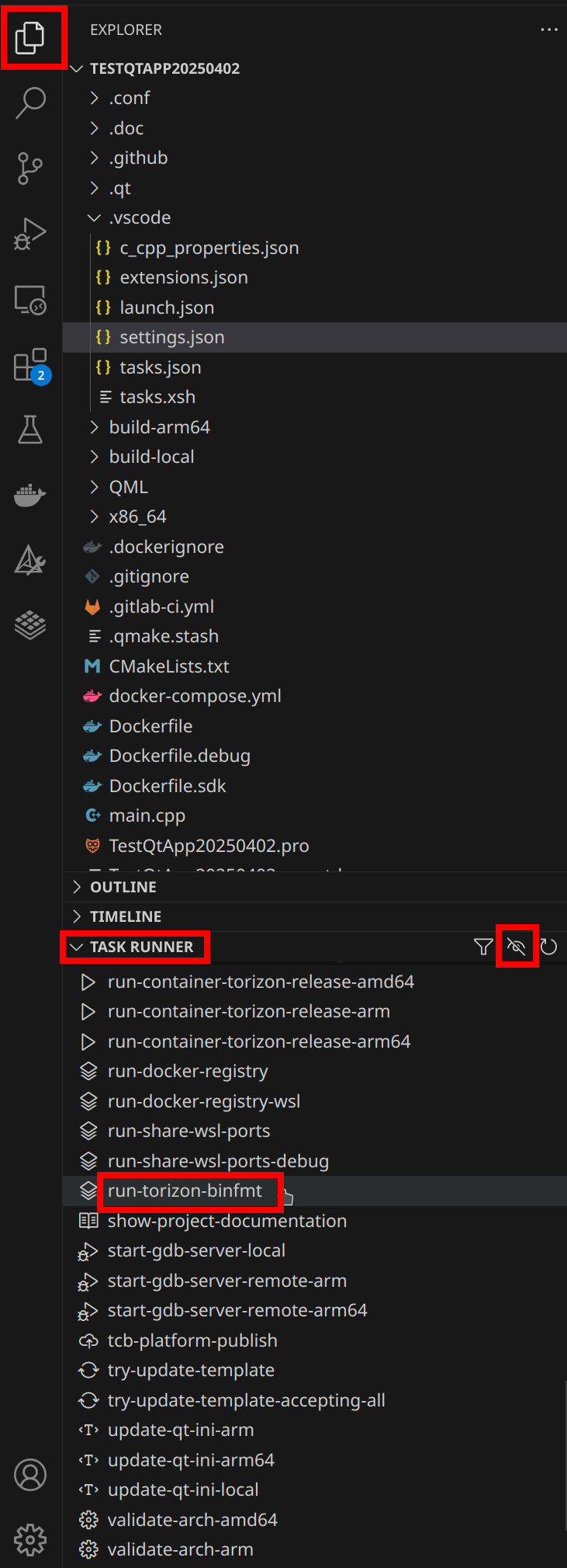

Can you run the run-torizon-binfmt task and try again?
It is under the task-runner pane of the explorer view.
You will need to click on the little eye highlighted to unhide it.
If this task fails for any reason, please send me the logs you see.

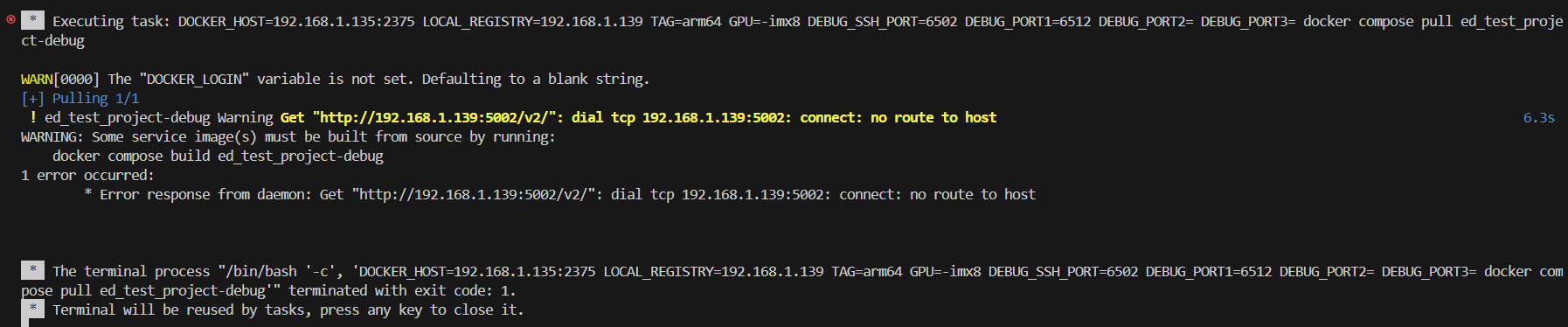

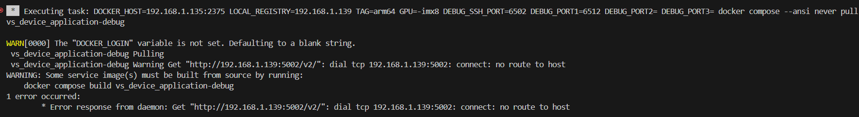

I will give that a go shortly, having another look today I got a message that the OS version on the target was too old which I had not seen before. I had picked up an old unit to use and have now upgraded it and get back to this message:
Hi @bruno.tx,
Fresh project gives the same error, this ran ok in the simulator and printed hello world. I think selected torizon arm64 in the debug menu and get here:

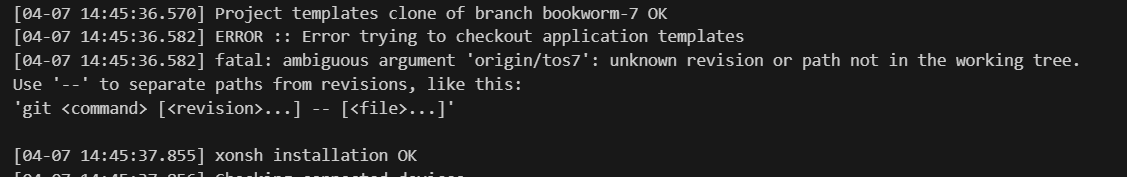

Going to 3.0.3 is broken for me with that error but 2.8.1 is working. The only thing I noticed is that during startup the extension complains about templates:
Thanks for your help, but maybe some better testing is required, at least on my machine your standard Python command line project is broken in the latest release.
