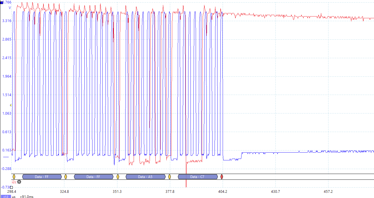

Communication typically end like that:
where the stop is not generated by the iMX8
I have modified a bit the driver to set RXWATER at the size of remaining data rather than 0 at the end of the frame as I’m suspecting that no interrupt is generated for the last byte, but I still have sometime an error as if a byte has been lost. I’m now suspecting it is not at the end of the frame.
