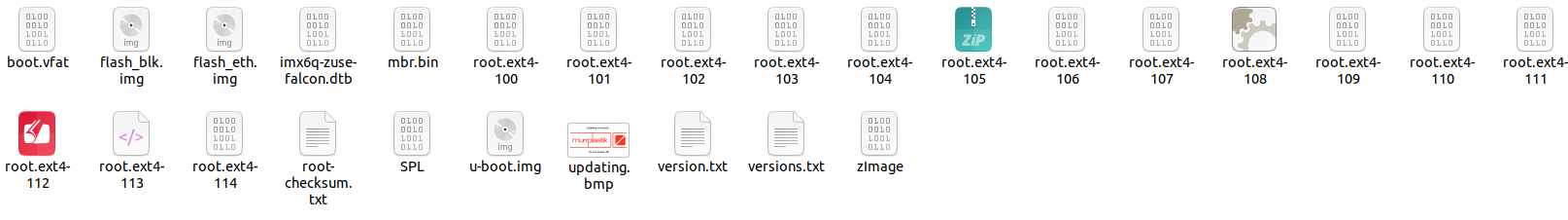

i want to flash yocto based custom image2.8b7 into my apalis imx6q 1Gb module using toradex installer through usb. The toradex installer doesnot flash the images files from the usb into the apalis module. The image files are shown below. Thank you
If you follow this instructions you will get a deployable tarball at build/deploy/images/${MACHINE}/. Then you need to unpack that tarball on your USB drive and use it to flash an image by Toradex Easy installer.
