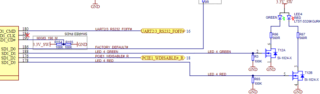

I’m trying to use the LED4 and LED5 on my apalis imx8qp on a ixora v1.2 carrier board.
I used the imx8qp-apalis-v1.1-ixora-v1.2.dtb device tree.
I can see the leds in sysfs under /sys/class/leds/LED_4_GREEN/brightness and I’m able to set and read the brightness, but the LEDs still stay all on.
Do you have any tips for further investigation?

Looking at the schematic:
The Ixora board does not have a default regulation of the leds. Linux by default populates the sys/class/leds section with the brightness option.
A workaround would be to toggle the pin to generate a PWM signal to adjust the brightness in this way. Not sure what effect this has on the performance though.
Can you maybe further elaborate on what the intention of this is?
Is the goal literally to change the brightness of the LEDs? Or is there a different task behind it?
Kevin
