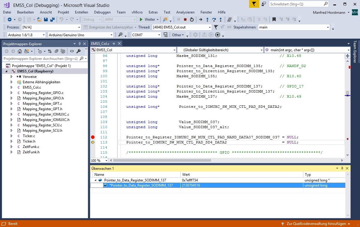

After 7z could not unzip Colibri-iMX6_LXDE-Image_2.7b2-20170410.tar.bz2 I found a very simple solution of my problem.
I copied g++, gcc, gdb and gdbserver from Raspberry to Colibri.
It works. Even with breakpoints on a running application and with breakpoints on memory acces.
Best regards :wink:
