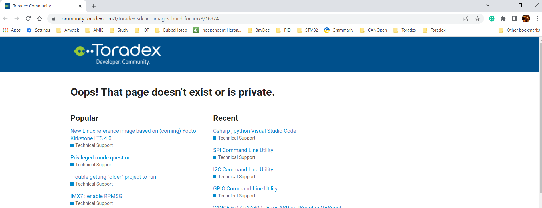

Hi
I am unable to access the link that you shared.
Here is the screenshot of error message.
Hi @Dhanyakumar ,
I updated answer please check.
