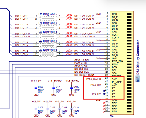

Dear @edvin.hansson,
Thank you for your fast reply. You are indeed correct, that on the Mallow board itself the switching off of the DSI display is not implemented, as can be seen on the following image:
If you would like to control the marked power supplies, I would suggest creating a custom board, in which these lines are power gated. Does this help you in your further evaluation?
Collin
