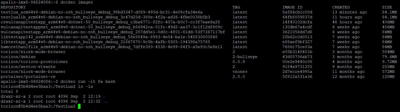

and what also confuse me is that the container doesn’t have the executable, so I can see what’s going on and try running the container in the putty.
Do you know why that is? see image:

Try doing a search both inside and outside the container for the executable name. I mean for debugging it must be executing from somewhere.
I tried the simple single c/c++ file template also, and still nothing inside the container.
only have the app folder
I search everywhere, nothing.
it only exist outside the container.
any idea?
For the debug configuration the executable and any other relevant files are bind-mounted from the host /home/torizon/<application name> into the container. What you did earlier was just run the debug container with bash which doesn’t bind mount the files in the container.
You need to look at the container while it’s running as it was ran by the extension. Do not attempt to run the debug container manually as this really doesn’t make sense in context. What you should do is run deploy/debug from the extension. The extension will remotely run the container on the target device with certain flags and arguments.
Then if you want to a shell in the container you can then use docker exec to get inside the container while it’s already running.
If you build the release version of the container then the executable and all files will actually be built into the container image. For debugging purposes the files are outside of the container on the TorizonCore host and then bind-mounted into the container at run-time.
