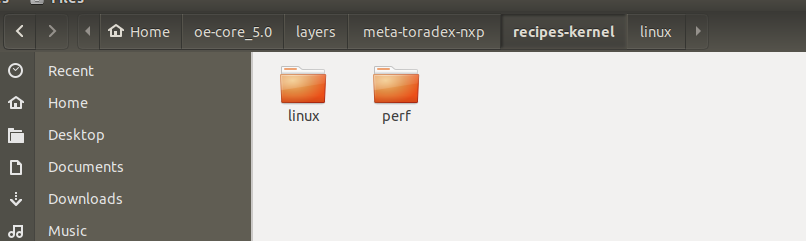

Hi @gclaudino.tx !
As you can see in the attached image I don’t have linux-firmware in the folder.
I followed the instruction in the article you sent me but it’s been a long time i did it.
Do you think I have to update my meta?

Hi @Merlin ,
You can download the new files from the link I just sent and add them to your recipes-kernel folder. Adding the linux-firmware folder shall be enough. Please do it and try again :slight_smile: .
Remember to check on your bblayers.conf that meta-toradex-nxp is listed.
