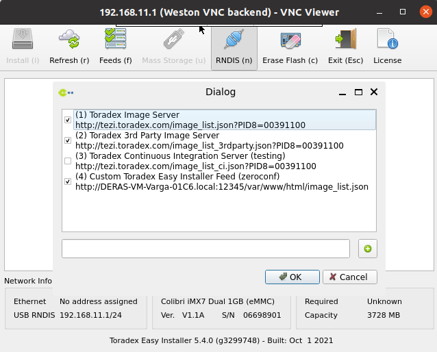

When I start the VNC Viewer and click at the Feeds tab, following dialog gets displayed:

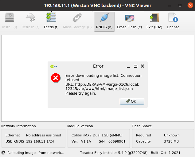

When hitting the OK Button, following error gets displayed (Error downloading image list: Connection refused):
What could be the reason for this issue?
