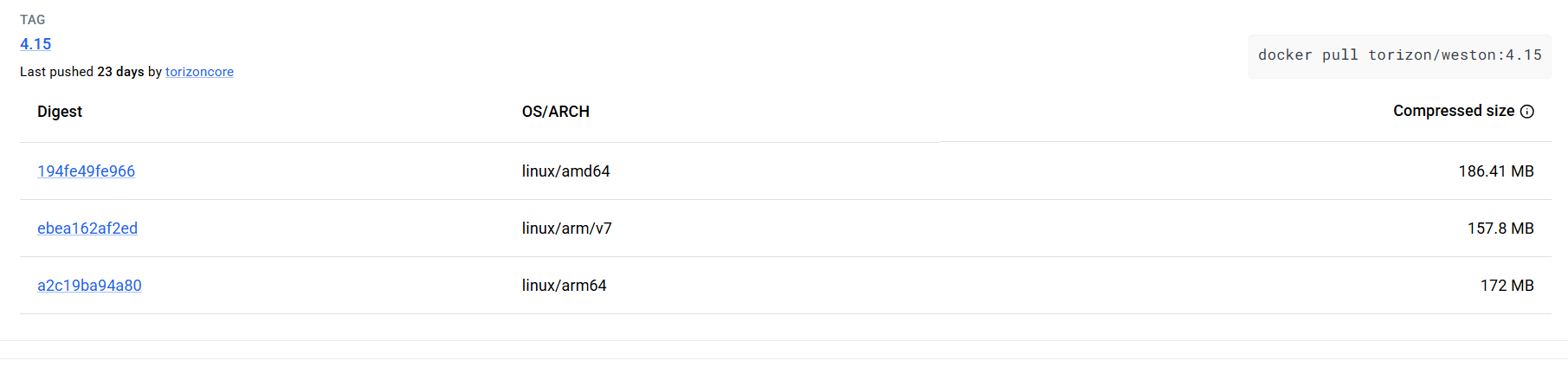

Hi @ToradexAI,
Thanks for the reply. In this moment i see that:
Do I need to use version 4, 4.15 or 4.15.0 ?
Thanks
Fabio
Greetings @fmolon,
First of all, you are looking at the container image torizon/weston. Since you are using a Verdin i.MX8M Plus, you should instead be looking at torizon/weston-imx8.

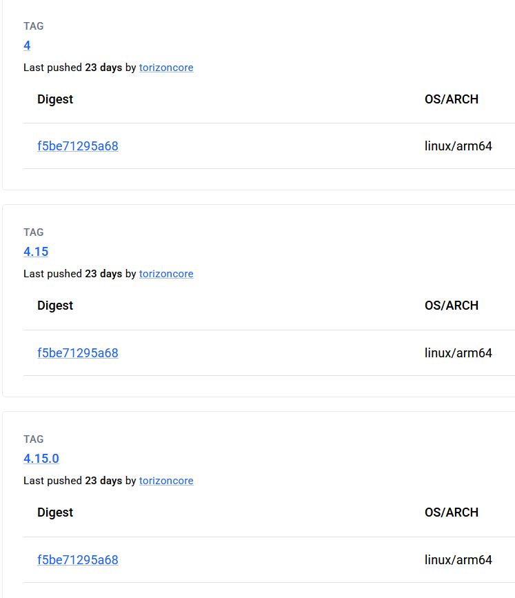

At this current time for torizon/weston-imx8 here’s what the versions look like:
Take note how the hash digest value for all 3 are the same. This means these all 3 refer to the same image. This is because 4.15.0 is the latest version at the time of writing, so these tags reference the same container image. This is not always true, but it just happens to be true at this time for this version.
As for what you should use, if you’re in development I would suggest using 4. That way you’re always working on the latest version of our container and get the latest updates. Keep in mind, our latest container versions are only guaranteed to be tested and compatible on the latest version of Torizon OS. When your product is in production, many prefer to stabilize on a specific version. In which case you could use 4.15 or 4.15.0 in this case.
