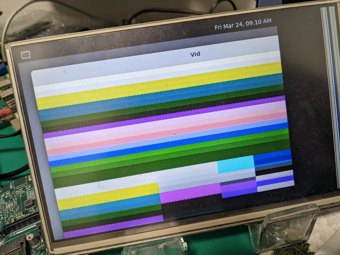

Please confirm that the result you get from the python is this:
If you get the same result
We don’t think this:
Continuous video playback with Qt → Starts after some time, you can clearly see the memory increasing, several fds, Gstreamer error saying not enough memory.
Single video playback with Python + OpenCV → No error, no memory, occurs always in the first time.
In that case, can we focus on trying to solve the Qt issue and forget about Python?
Please ignore the sample code I sent for continuous video playback.
This is the difference between waylandsink or ximagesink. In the end, ximagesink gives the same result.
The waylandsink looks nice but flickers when it starts. This is also strange.
It is currently playing back in a different way.
Therefore, no memory leaks, etc. are occurring.
However, the playback itself is wrong and cannot be avoided.
