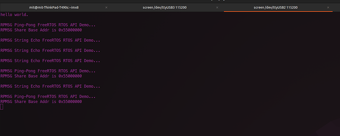

I’ve gone into the bootloader and started the Ping-Pong demo on the M core:
I’ve started the RPMsg ping pong task on the A core:
But still no output from the M core.

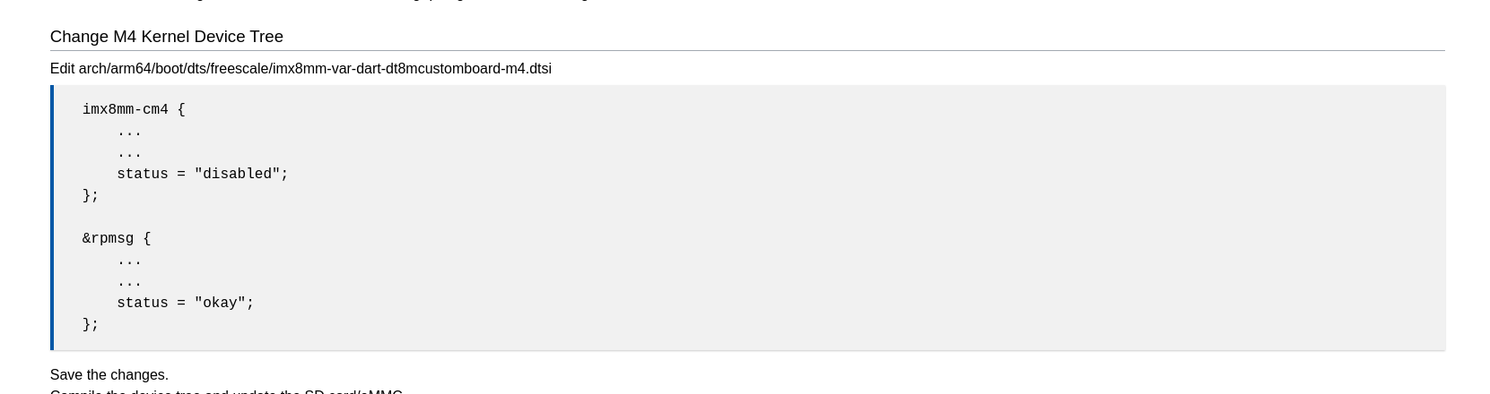

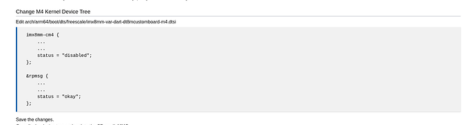

Hey @eric.tx ,
Do I have to make any of the changes mentioned here: https://variwiki.com/index.php?title=MCUXpresso_VSCode#Debug_RPMSG_demos

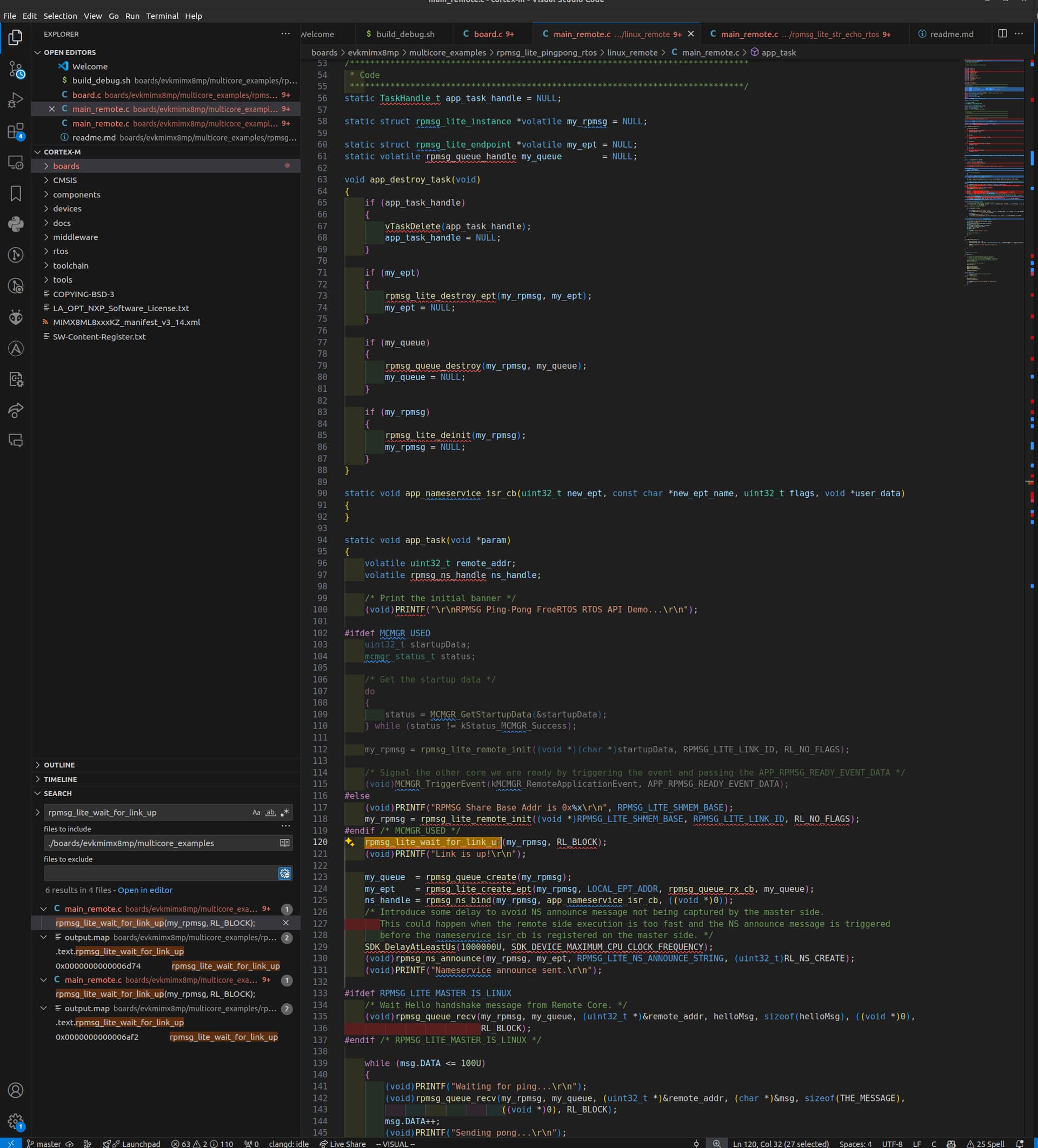

I’m trying to debug why the RPMsg “Link is up” message is not appearing on the M core side as outlined on line 120 of: ~/cortex-m/boards/evkmimx8mp/multicore_examples/rpmsg_lite_pingpong_rtos/linux_remote/main_remote.c
Best,
Mit
Hey @mit,
No, this is for a different SoM and different NXP chip (IMX8MM vs IMX8MP)
Can you share your uboot environmental variables and toolchain version?
-Eric

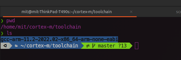

Hey @eric.tx ,
Thanks for the clarification, below are the requested information:
  1. Toolchain version: gcc-arm-11.2-2022.02-x86_64-arm-none-eabi

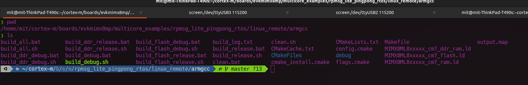

And this is the demo that I am building:

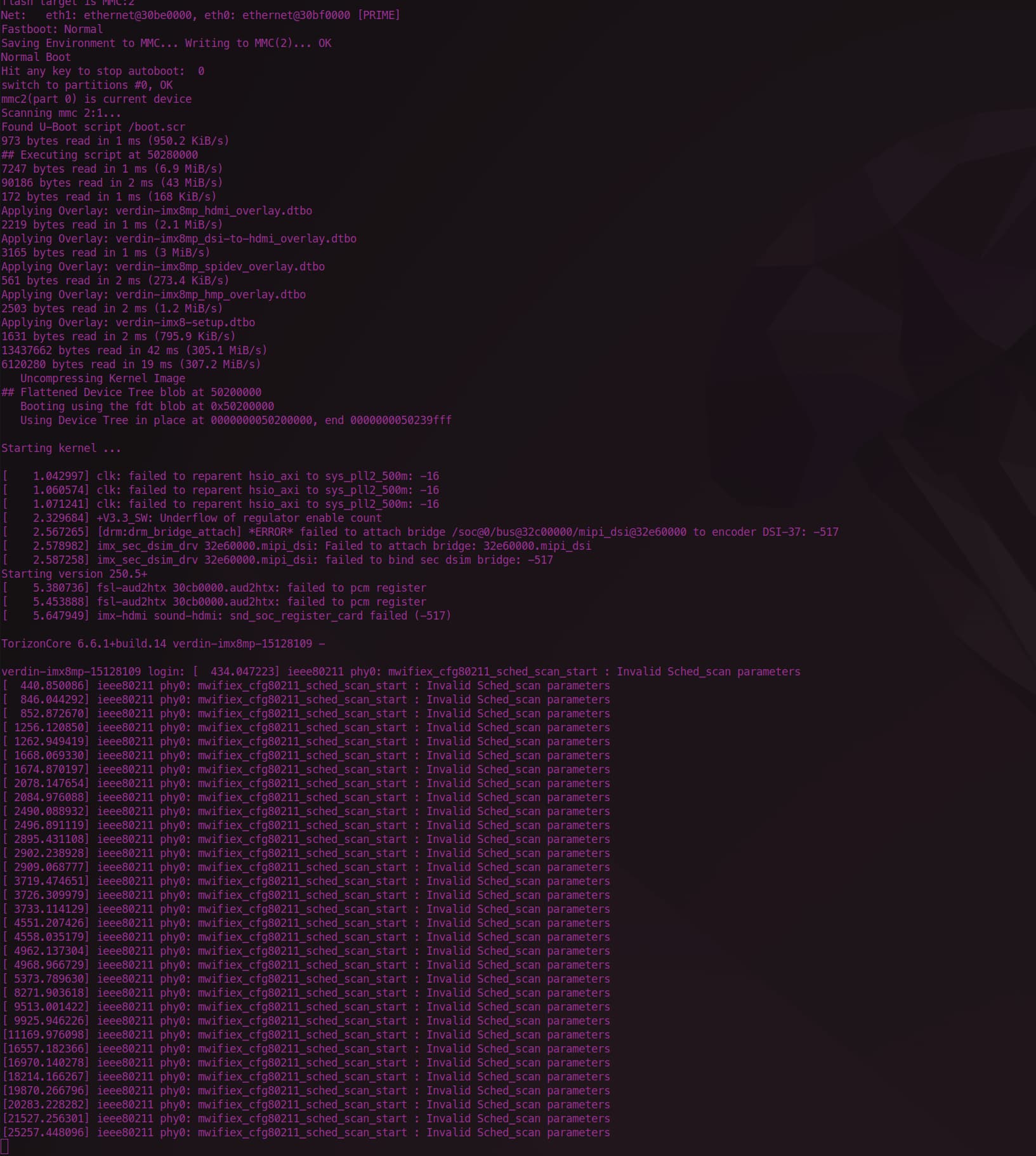

Seperately, should I disable Wifi from the device tree to resolve this error that keeps printing to the console ? :

Some things that I tried today to try to resolve the issue:
I ran through the following: Need help to set up rpmsg on dalhia board with imx8m-plus - #5 by henrique.tx
  1. Heterogeneous Multi-core Processing (HMP) Documentation Overview | Toradex Developer Center
  2. Setting Up MCUXpresso SDK and Toolchain for Cortex-M development | Toradex Developer Center
  3. How to Load Compiled Binaries into Cortex-M | Toradex Developer Center
  4. How to Run Hello World on the Cortex-M | Toradex Developer Center
  5. Cortex-M RPMsg Guide | Toradex Developer Center
  6. How to Use RemoteProc | Toradex Developer Center
And made sure that the RPMsg memory addresses for vdev0vring0, vdev0vring1, rsc_table, vdevbuffer were all based off the 0x55000000U as defined in ~sdk/multicore_examples/rpmsg_lite_str_echo_rtos/board.h:
/* Shared memory base for RPMsg communication. */
#define VDEV0_VRING_BASE      (0x55000000U)
#define RESOURCE_TABLE_OFFSET (0xFF000)
And I’m still unable to establish the RPMsg link. On the A core side I only see the following:

[    1.329111] virtio_rpmsg_bus virtio0: creating channel rpmsg-virtual-tty-channel-1
as outlined here: Cortex-M RPMsg Guide | Toradex Developer Center
Let me know what you think.
Best,
Mit
Hey @mit,
Just an update, still looking into this.
-Eric
Hey @mit,
I found a variable name error in our “How to Load Compiled Binaries into Cortex-M”
For the Application Start, you want to run the newly created cm_boot . Not the "run m4boot" . This change was made because m4boot was a little unclear when working with a Cortex M7. I put in a change request for the website to reflect the correction.
Aside from this change, following the instructions works as expected.
-Eric
