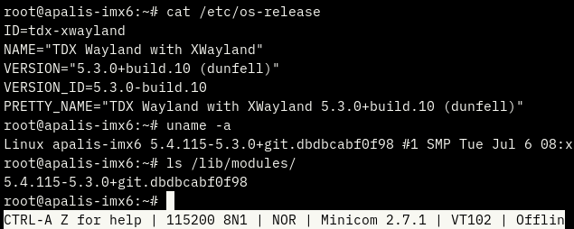

After installing Reference Multimedia Image 5.3.0, you can see in the image below that there is no folder inside /lib/modules
that starts with 4.1.44
Also I could find:
/lib/modules/5.4.115-5.3.0+git.dbdbcabf0f98/kernel/drivers/media/platform/mxc/capture/adv7180_tvin.ko
/lib/modules/5.4.115-5.3.0+git.dbdbcabf0f98/kernel/drivers/media/platform/mxc/capture/adv7280_tvin.ko
/lib/modules/5.4.115-5.3.0+git.dbdbcabf0f98/kernel/drivers/media/platform/mxc/capture/max9526_tvin.ko
Henrique
