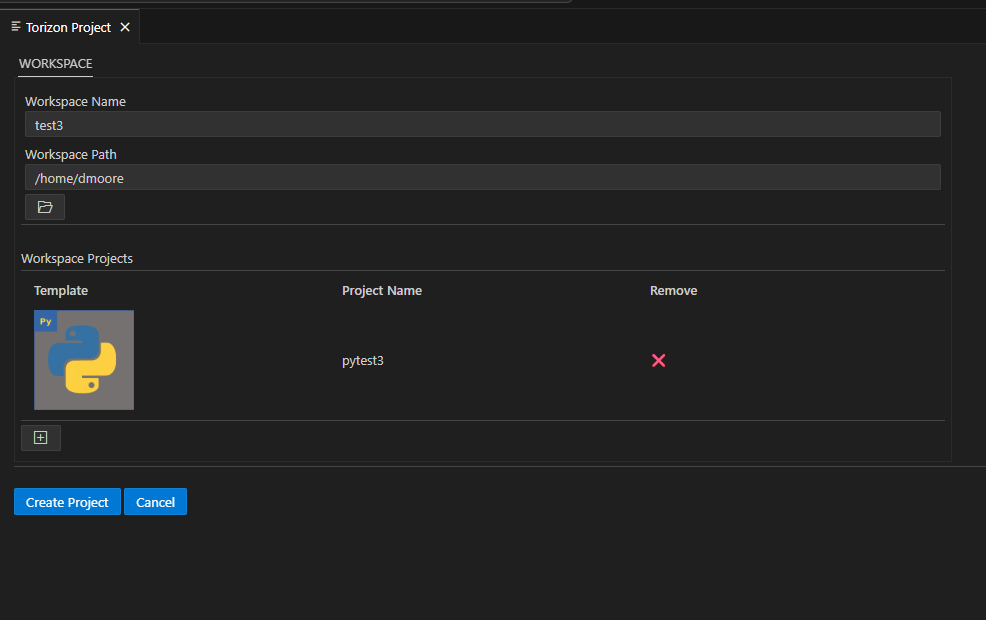

that was the name of the workspace I used on the first screen. I then add a workspace project and it looks like this:
After hitting “Create Project” the “Output” tab has:
[08-18 10:33:05.225] Creating application pytest3 based on template python3Console
[08-18 10:33:06.430] ERROR :: Error trying to create project
[08-18 10:33:06.430] ERROR :: There were issues during the creation of the projects
And the .apollox.cmd.log pops up and shows:
Data:
Template Folder: /home/dmoore/.apollox/python3Console
Project Name: test3
Container Name: pytest3
New Project Path: pytest3/test3
Template: /home/dmoore
Is VS Code: False
Send Telemetry: True
Has Custom Fields: False
Error: Template ‘/home/dmoore’ not found in templates.json
Error cause: Not found
A “test3” directory never gets created off /home/dmoore (that’s the WSL directory) where other projects get created. This is all using the pre-release, things worked before the pre-release changeover.

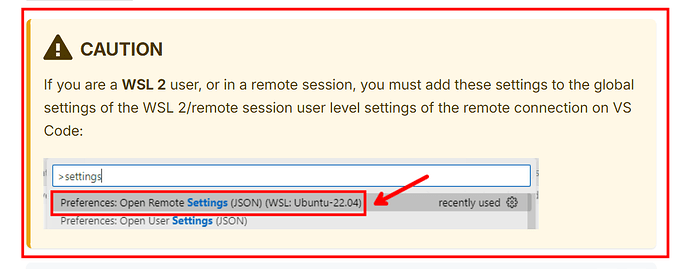

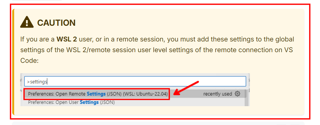

thanks for the data. So, from the logs you can see that the templates is coming from stable instead of the dev.
From here Settings - Using Templates Development Branch | Toradex Developer Center you can see that there is an warning:
You are probably editing settings.json from Windows side instead of the one from WSL side.

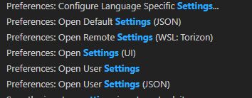

Should I be looking somewhere else?

Okay…found the right settings file. Sure are a lot of them…

And, project creation was successful!
I’ll let you know if I encounter any other interesting stuff.
Thanks!
